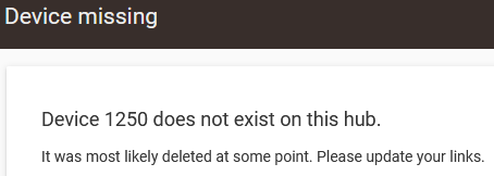

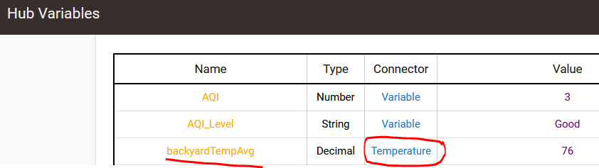

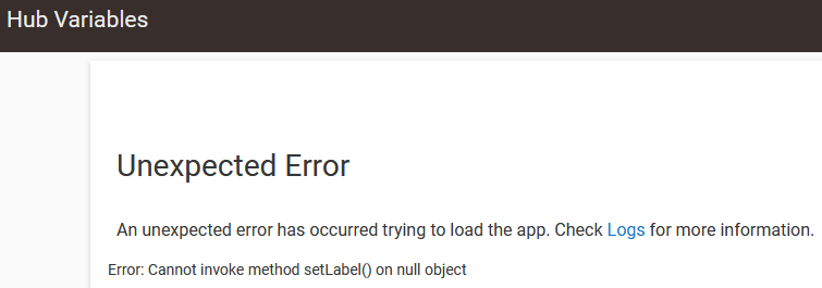

I'm experiencing this issue on v2.3.5.152
Clicking on Temperature under the Connector column leads to:
A hub reboot does not resolve this issue.
So probably you should take the error message at face value, and the Connector device was deleted somehow without that updating Hub Variables. I'd suggest removing that Hub Variable completely and redoing it.
Also, what you're pointing out is not related to Hub Variables In use by, but something else completely.

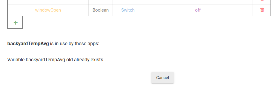

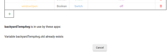

I just tried renaming the existing 'backyardTempAvg' and received this:
Then upon returning to the Hub Variables page:
The rename is 'successful'

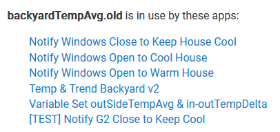

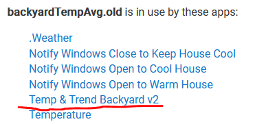

I removed backyardTempAvg.old from 'Temp & Trend Backyard v2' but it is still listed as In Use By:
Interestingly, removing the backyardTempAvg.old Hub Variable from Dashboards (.Weather and Temperature) results in those Dashboards not longer being listed as In Use By:
But the same cannot be said for Rules: 'Variable Set outSideTempAvg & in-outTempDelta' is no longer using the backyardTempAvg.old Hub Variable and has been renamed.
Therefore it appears there is an issue with In Use By and RM.

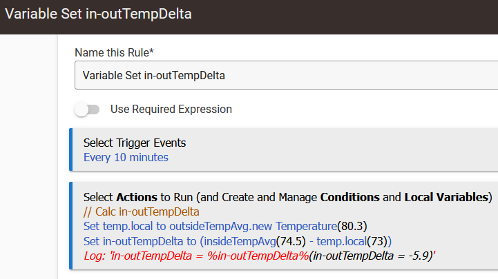

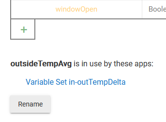

Here's another Hub Variable In Use By bug:
What you're pointing out is that a disabled action still counts for In Use By, as it should. If you don't want it to, delete that action.
Incorrect.
The disabled Action in the screenshot above is referencing in-outTempDelta
The Hub Variables page is listing outsideTempAvg as In Use By.
in-outTempDelta
and
outsideTempAvg
are not the same variable.
Maybe I'm mistaken but I don't see where outsideTempAvg is In Use By the Variable Set in-outTempDelta rule I pasted above.
