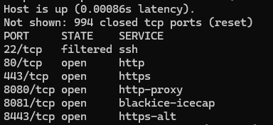

Okay, this is interesting. Port 8081 is alive according to nmap, but the browser never loads anything. In my mind, the OS is alive, but the service isn't answering.
make sure you're using http not https when you try to g\et to it as well.
