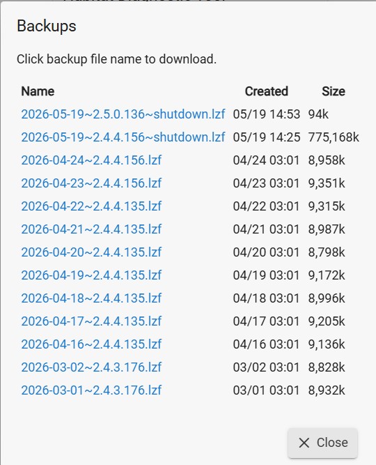

Thanks for the response, I will do that. I was just looking at the backups and noticed the huge 775,168k .lzf file that was created when I did the upgrade. Is that normal?
No. That is definitely much larger than I have ever seen.

Before I do the restore, I am going to delete that very big .LZF file - is there any problem in doing that?
