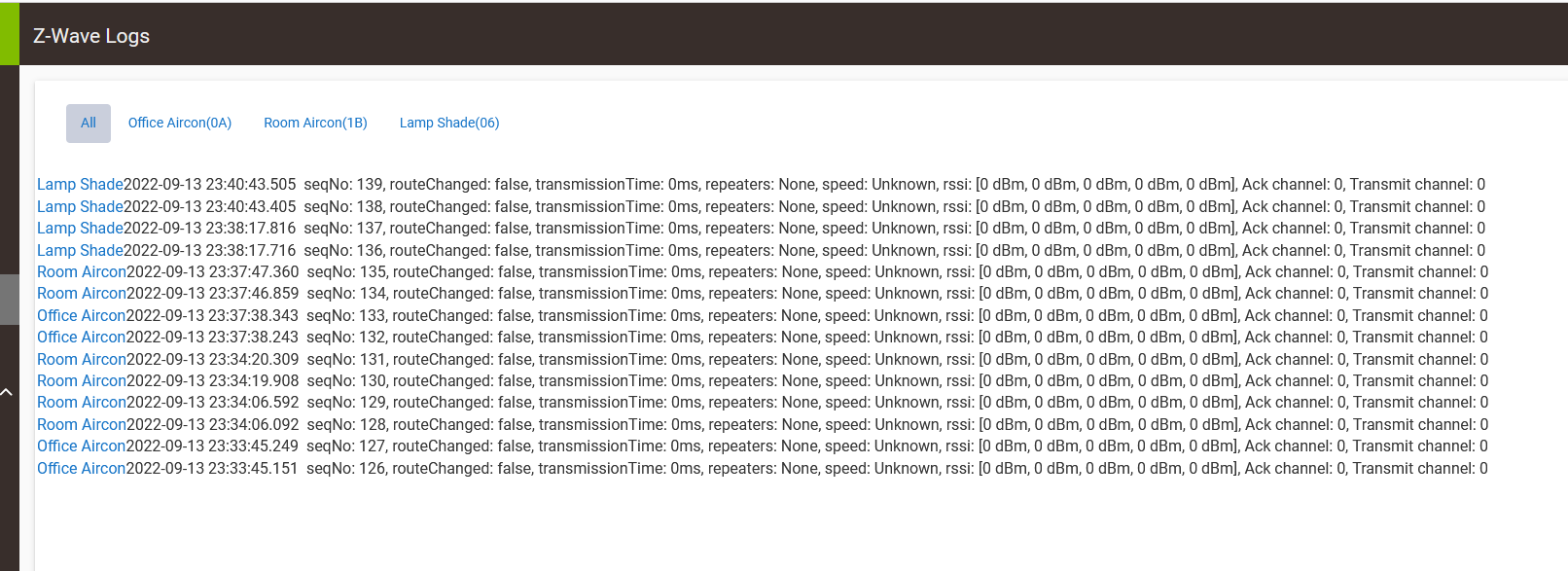

I tried to monitor the z-wave logs and this is what i got
basically, when i control the plugs thru alexa or directly thru the UI, the logs would show updates instantly... that tells me that there is no lag between me issuing the command and the hub receiving it and executing that command towards the devices - but the devices just dont do anything.

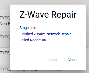

So i tried to do repair thing on LAMP SHADE first.. and this is what i got..
i dont understand what that failed node means but the plug is definitely still unresponsive after finishing the repair thing

If it fails, then new route couldn't be established because the controller couldn't communicate with the device. So it will remain unresponsive until the connection is re-established. The reason is not recommended to run a full repair is that IF for example node 06 was functional better routes could be established, but since the device is non-functional, then less efficient routes are selected. Ensuring that all nodes are functional is key to best routing. Performing repair on individual device is best in determining a bad player. Once the repair fails, you have the confirmation that the device isn't communicating properly with the radio. In this situation you have several options:
  1. exclude/reinclude hoping that what ever was the cause of failure will not happen again
  2. add repeaters between the failed device and hub, to ensure the device can communicate better.
  3. remove the device and replace it with one that can communicate with the hub better.
Other things you can try: update firmware on the controller and/or update firmware on the specific device,
