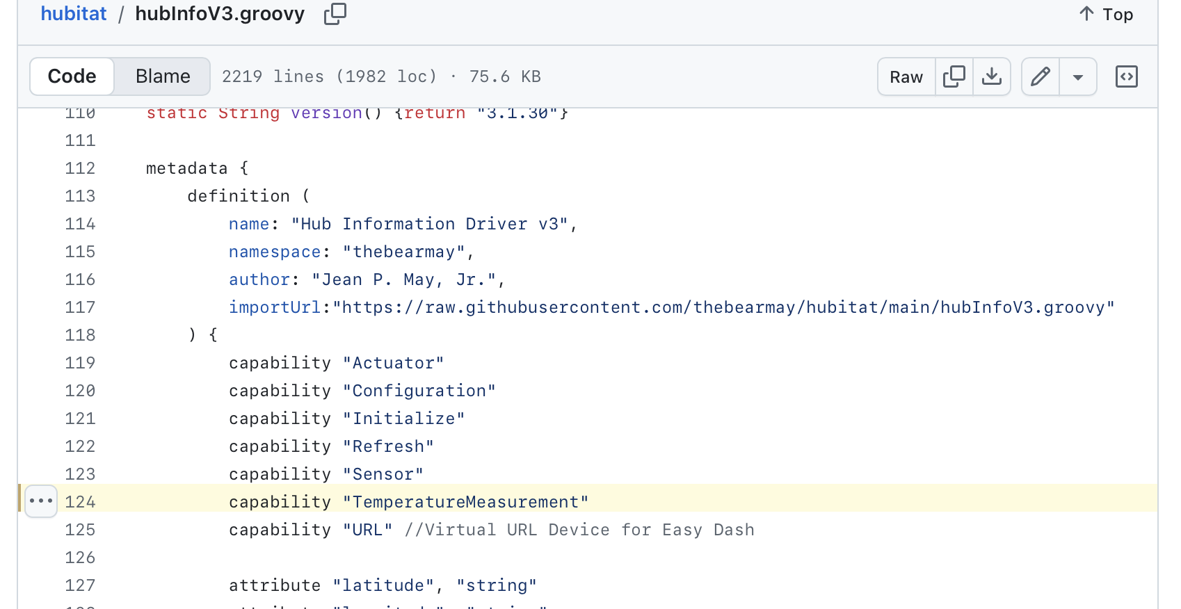

Comment out line 124
Are you using a built-in app or driver that exposes the hub's temperature as an attribute? If so, which one is it - I am unaware of any.
Hi @thebearmay - I didn't realize I was getting that value off your driver - I honestly thought the hub was reporting it to me. No need to tweak an amazing tool - sorry to bother.
