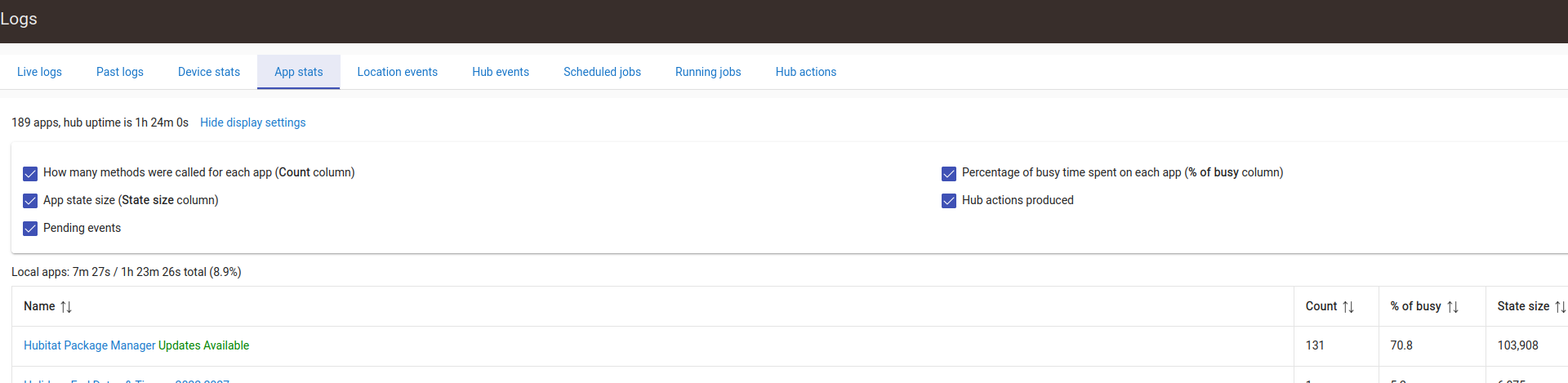

  1. App stats: 8.9% - not too bad

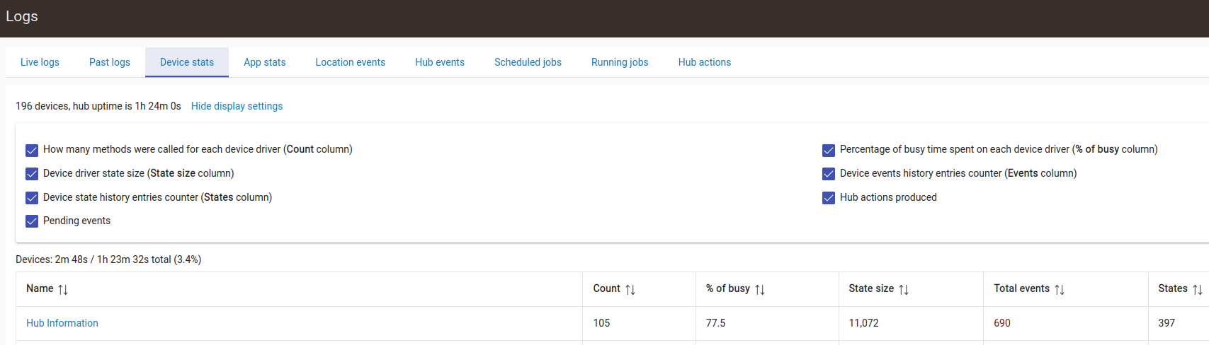

  2. device stats: 3.4% - not too bad

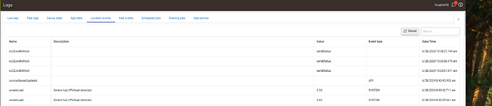

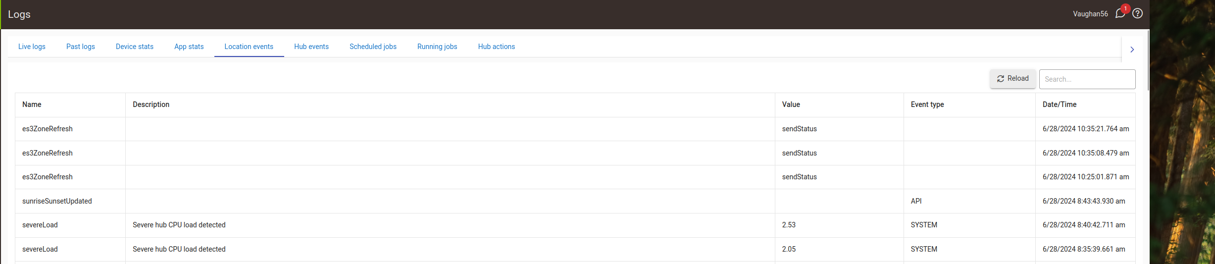

Not seeing any issues there. When are you seeing the Severe Load message (not unusual to see it for a couple of minutes after a reboot)?
It wasn't after a reboot, but I did reboot after I saw it, and it hasn't reappeared.
