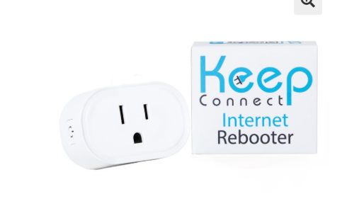

As for your router you can do a smart reboot using a product called keep connect. It monitors WiFi and WAN connection and if it detects a persistent outage it reboots the router/modem by power cycling it. I have this in both of my locations so the wifi system can be self recovering if I lose wifi or internet connectivity. It is around $60 so not overly expensive.
