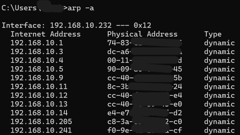

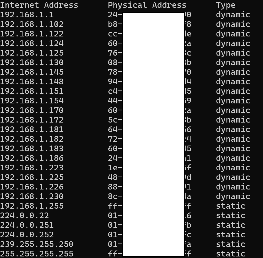

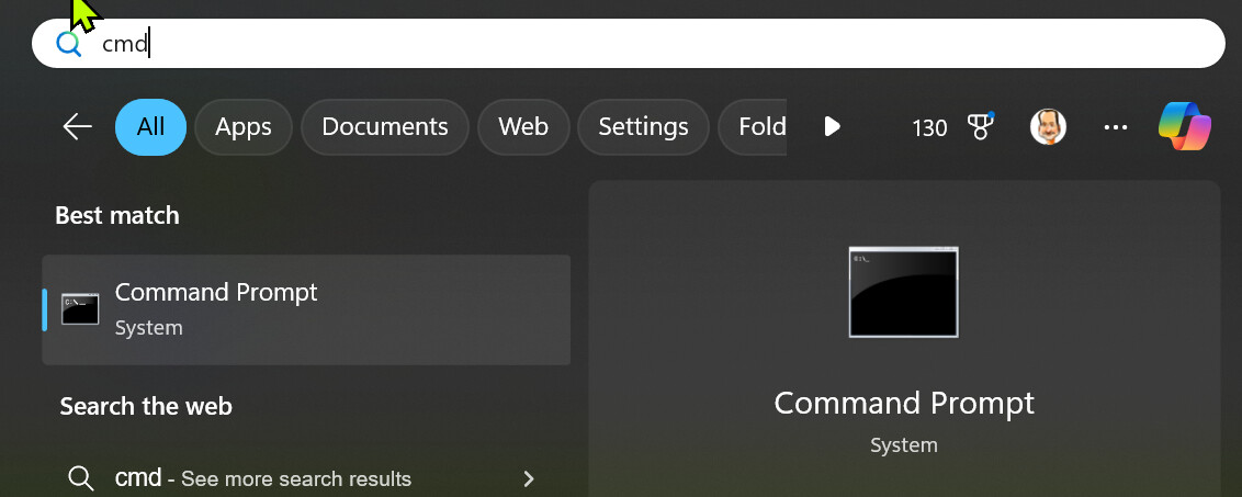

So you looked for the MAC address on the back of the hub (really long set of numbers and letters) and checked that against the list that arp -a gives (run the apr -a at a Windows command line). If you need help getting to a windows command line, put cmd in the windows search field...then run the Command prompt app.
Look for your hub's MAC address on in the list under the Pysyical Address column:

Yes, i did go into cmd and checked the list i did not find the mac address. I even also installed Ip scanner, couldn't find there aswell
Mac address: starts with 34xxxxxx
