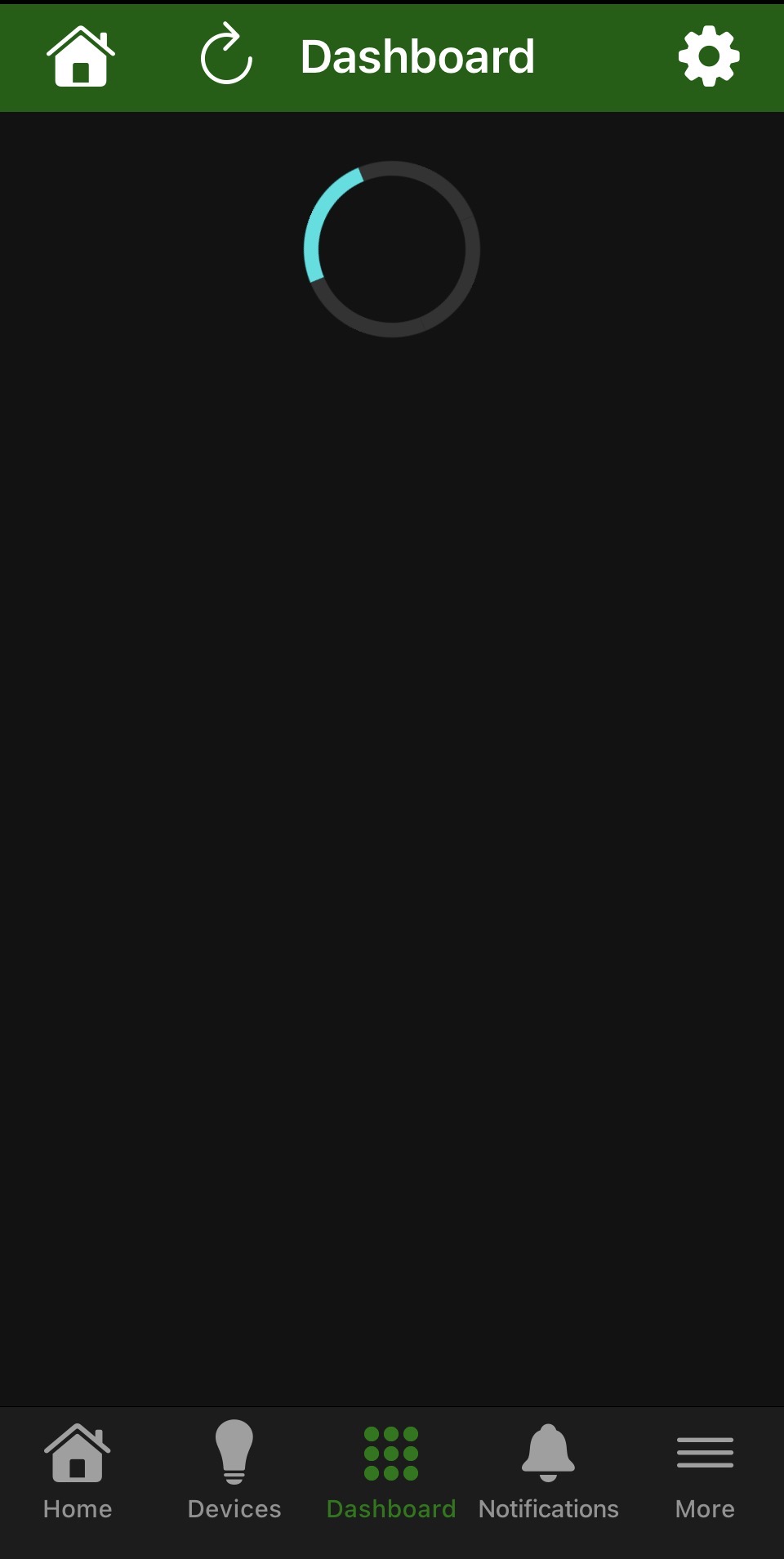

I’m not sure what else to add. Everything was working fine a few days ago, but now none of my devices are responding. I have 7 X-Wave inlines and over 10 Leviton Z-Wave switches that are all offline. On top of that, whenever I try to access my dashboard, I only see a blank page with the loading circle, and even when it finally loads, some devices still don’t respond.

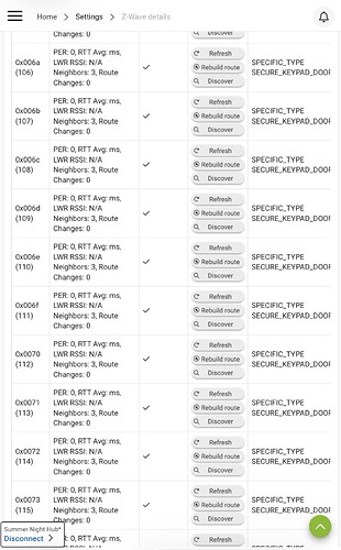

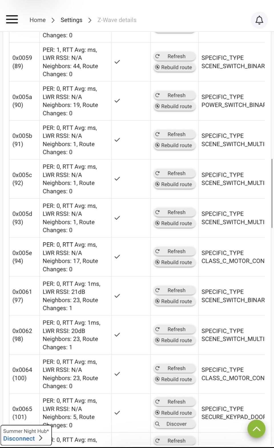

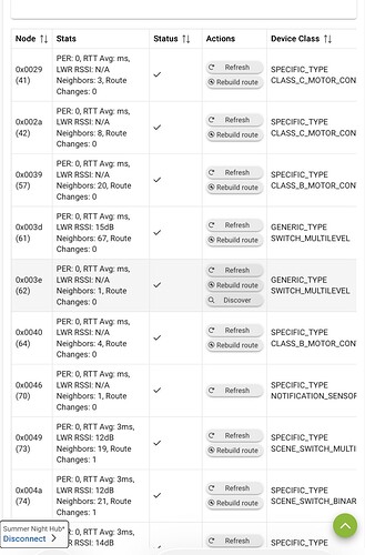

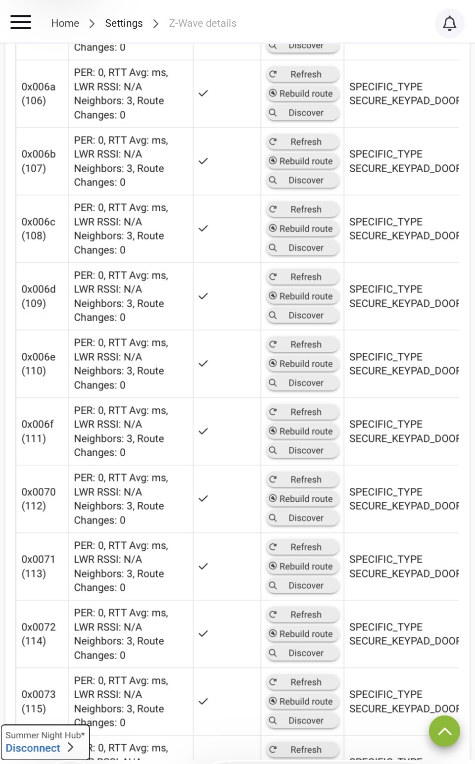

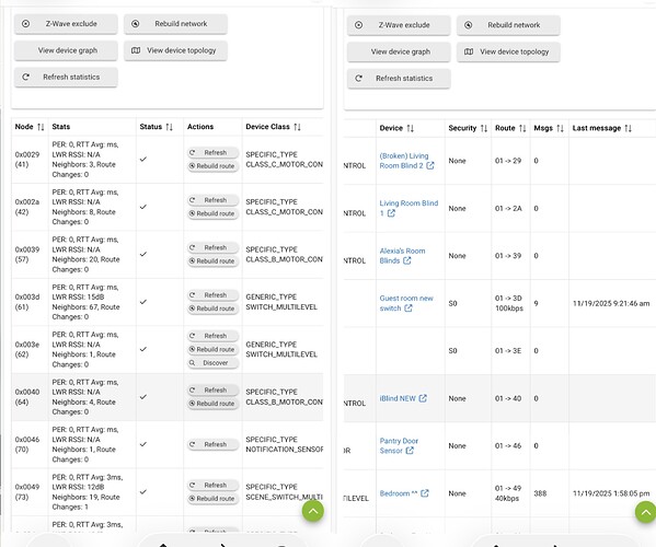

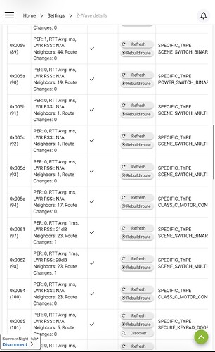

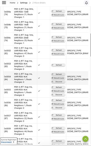

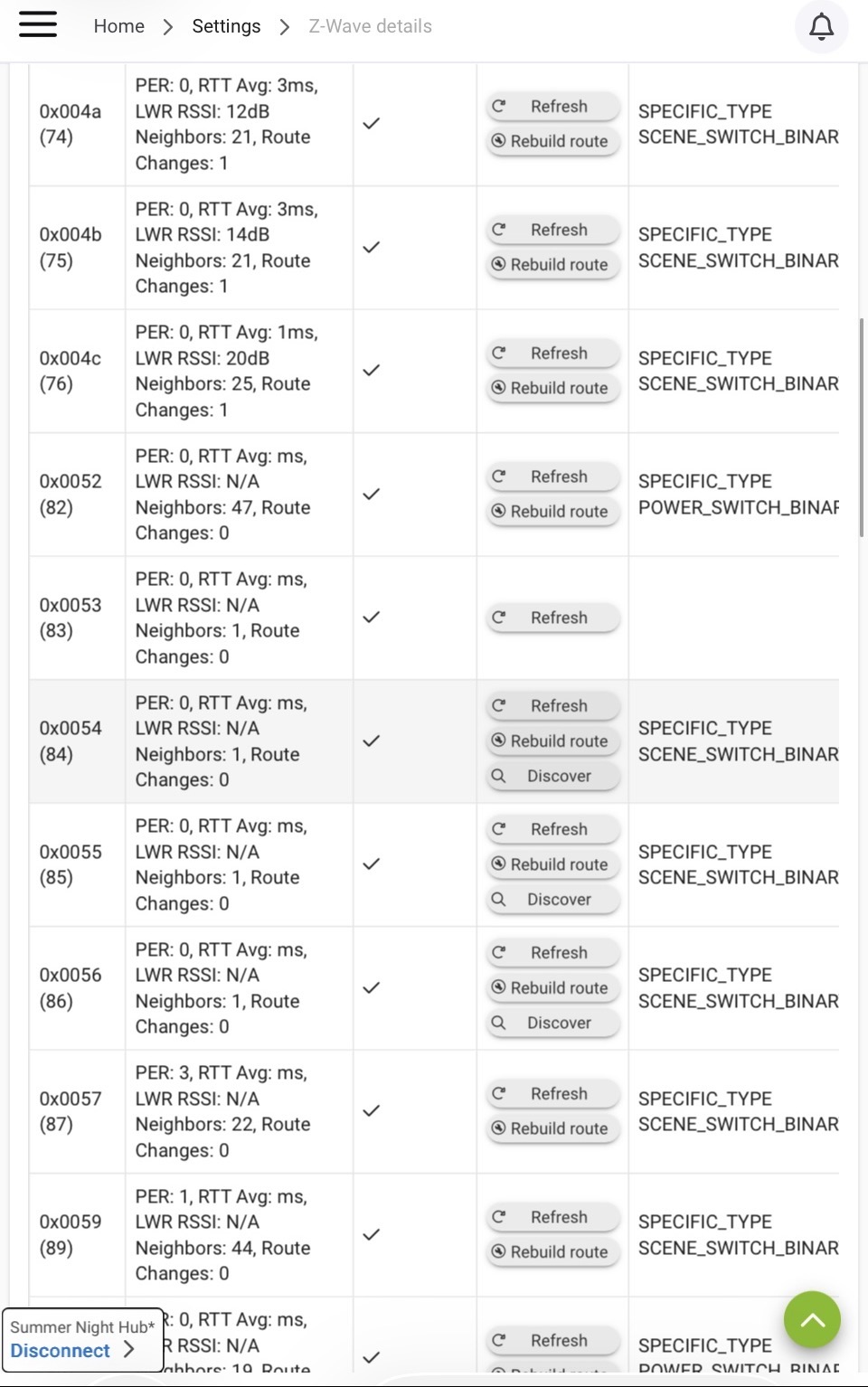

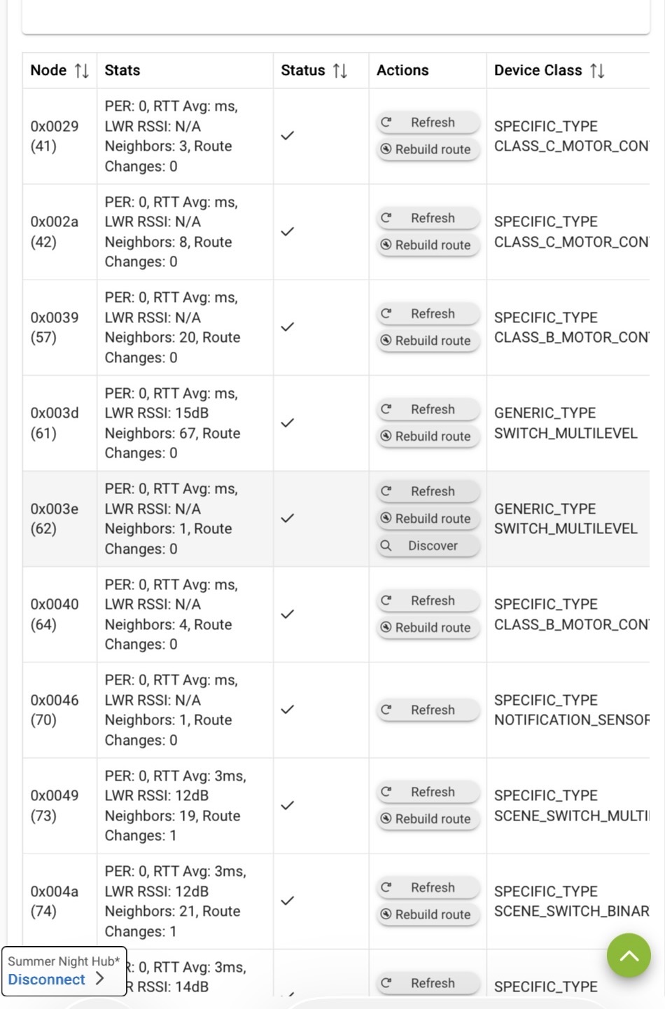

Post the contents of that entire table - don't copy and paste, post it as screenshots (multiple is fine). The content of that table may provide clues.....

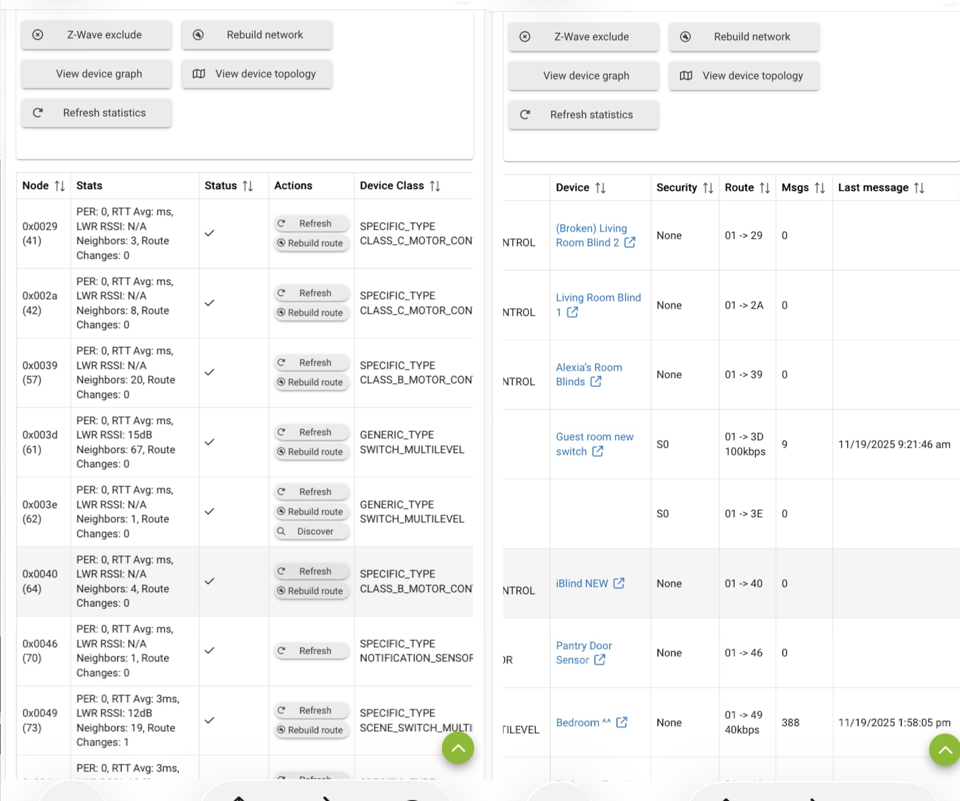

Is this what you are asking for?
Yes but because you've screen shot from your phone not a PC browser you've missed off the last 6 columns so there's insufficient information there...
You have at least 1 ghost it looks like....
How do I know it is a ghost device?
