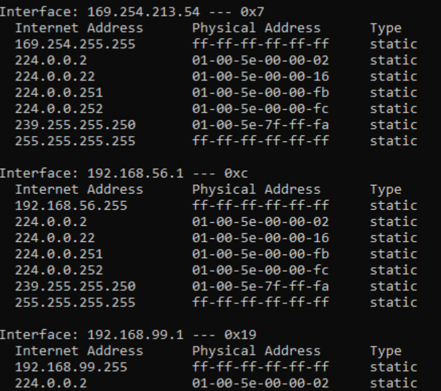

As a last ditch attempt, I plugged my laptop directly into the Hubitat, i.e. not including a router and with the wireless on my laptop disabled so that I wouldn’t be connected to anything else at the same time.
Here are the IP addresses that came up, is that at all helpful?

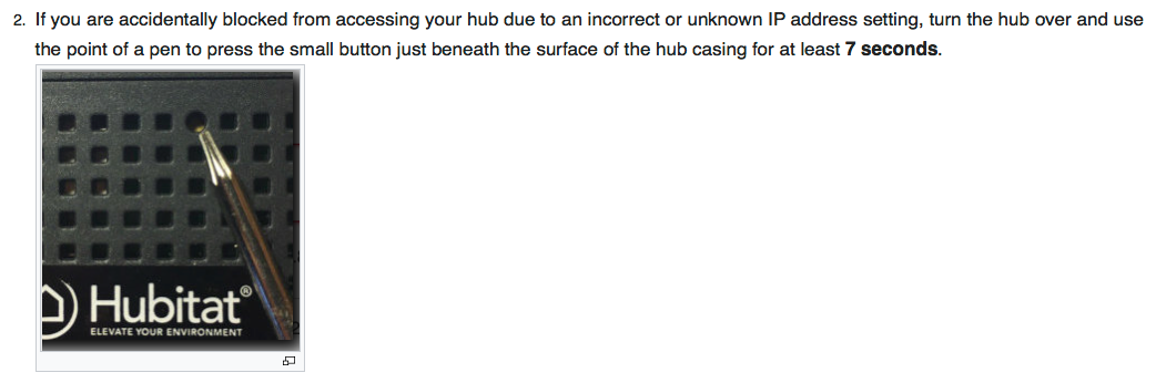

Was this purchased used from a third-party reseller? It is possible that the original owner set it up for a static IP on their network, and therefore it is not requesting an IP address from the DHCPd on your network.
You can fix this using the little red reset button on the underside of the C-7 as directed here:
These instructions are from the Hubitat Documentation:
https://docs.hubitat.com/index.php?title=Networking
