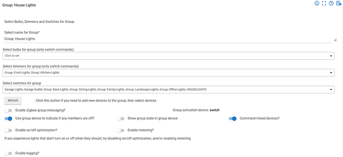

I've had similar issues with groups where a set of lights belong to a group and you ask that group to turn on/off. I would look at the different methods for controlling the group at the bottom of this screen snapshot. If you want more details on what it does, refer to the documentation or google it.

I tried using the Groups and Scenes to group a bunch of smart switches together. It works great to turn all on or all off.
However, upon all off, some of the physical smart switches remain at "on" state when they are in reality off. Is there a way to correctly reflect the true state of individual switches turn are turned off by the Group switch?

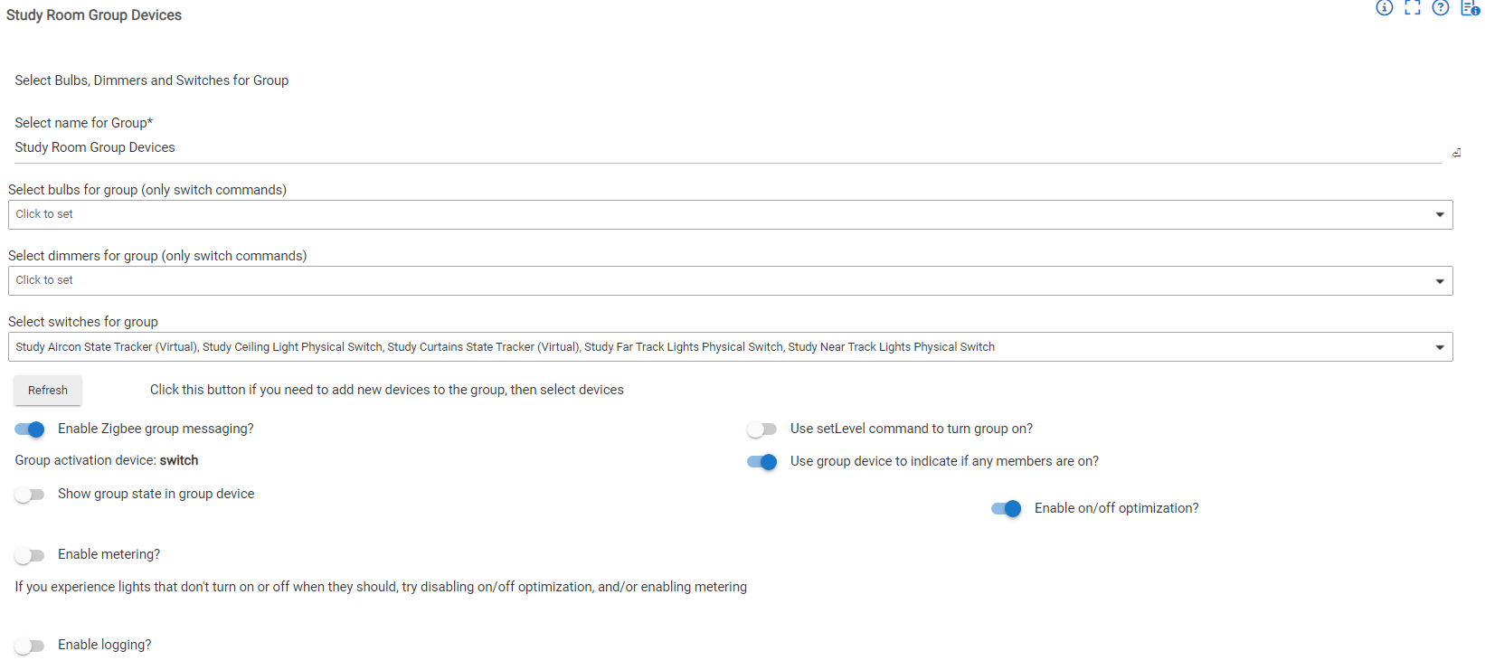

My settings:

Try turning on command retry for those devices, if they are turning off they are obviously getting the command but for some reason the reply is not making it back. Command retry would send another off command and hopefully it will respond the second time.
Also you may want to turn the optimization setting off, so that every device is sent the on/off commands regardless of their state (in case any do get out of sync).

This seemed to have resolved the issue with incorrect state!

In theory, yes. But from your screenshot you have Tuya devices.

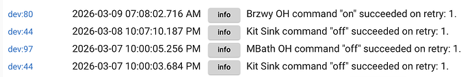

I have retry turned on for all my devices.
I haven't done this lately, but have filtered on 'retry' to kind of check on things:
edit: I missed my ZEN16's. So, hopefully everything's on 'retry' now.
