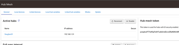

I'm having a number of Hub Mesh issues: enabled/disabled back and forth.
I looked at the Hub Mesh page of one of my Hubs(Vaughan56) and I noticed that it has a Hub Mesh Token.
I have never put on an UI security!
How do I take it off? (only part of it is shown in the following):
How did it put on a Hub Mesh Token all by itself?

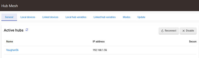

Also, please note that a hub which is trying to link to the hub previously mentioned, says that it has no security:
Having a token makes no difference if UI security is not enabled.
Not sure how it got to be. I can add an endpoint to clear it out.
I can also make some tweaks to the discovery process. This will need a bit of testing.
