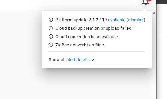

In fact, when I check for updates from that hub, I see:
Actually it should detect 2.4.2...
But, I still get the message that no updates are available when I click on the 2.4.2.119 link:
I think the important part there (from your earlier screenshot of the notification pop-up) is that the cloud connection is unavailable. My guess would be that is the connection to HE services, not necessarily the cloud (Internet) in general, but others will be able to confirm that.

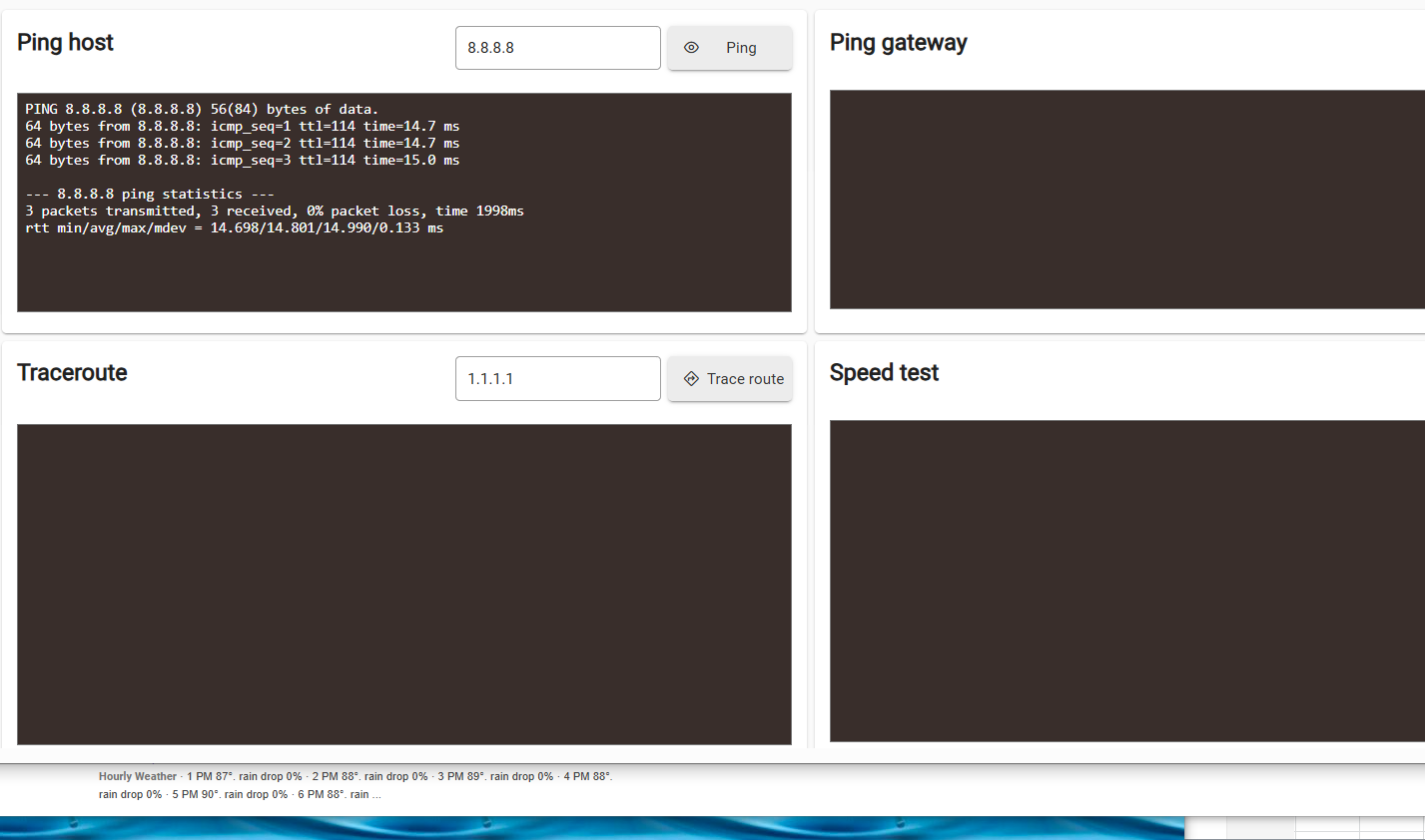

Are you 100% sure you have connectivity from the hub to the Internet more generally? If so, maybe to rule out any gremlins, and if it is ok with you, what if you rebooted the hub?
Yes, internet is accessible--see the ping I just posted.
I will reboot the workshop hub...
Ok. Otherwise, unless someone else has any suggestions it might be one for HE support to follow up... But let's wait and see if the reboot does the trick.
Rebooting the hub fixed the issue! Updating now.
