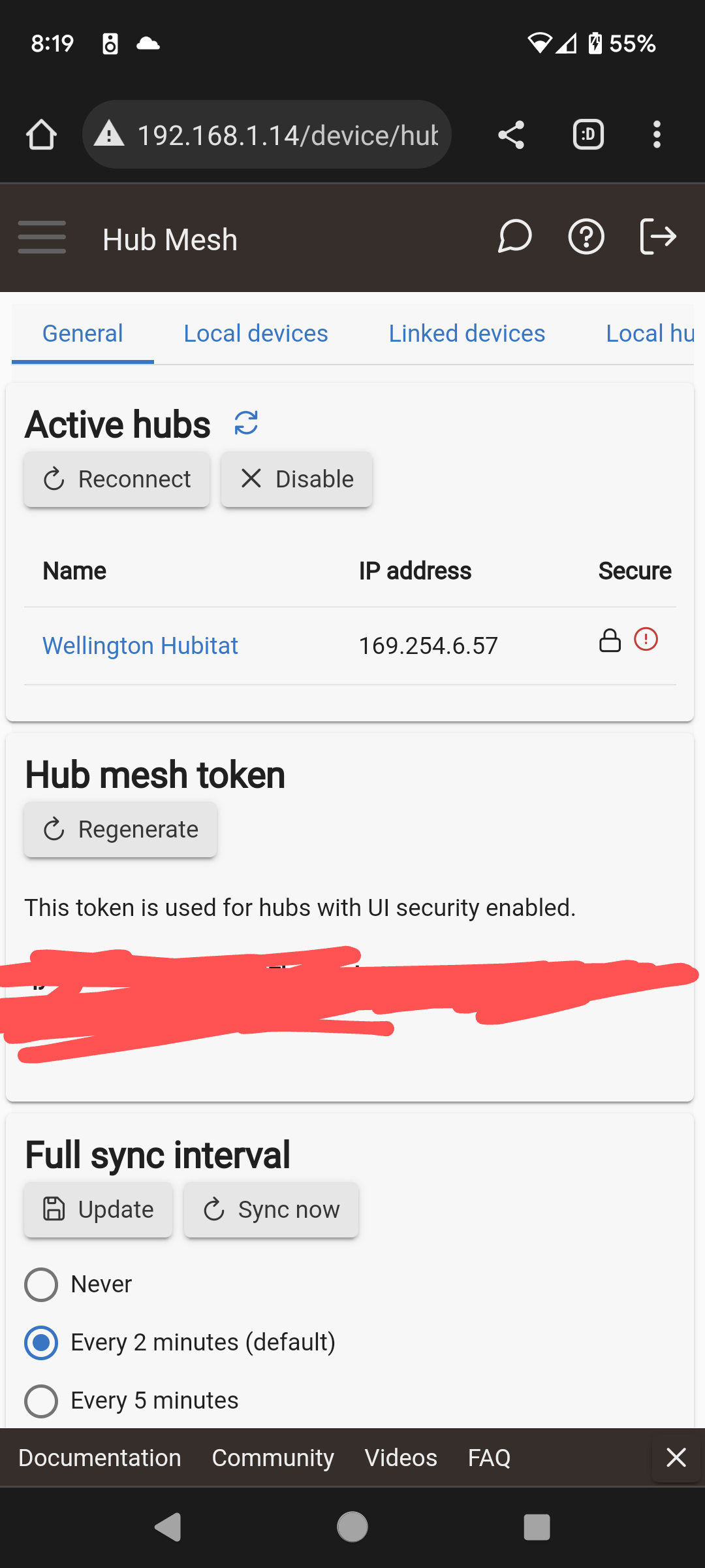

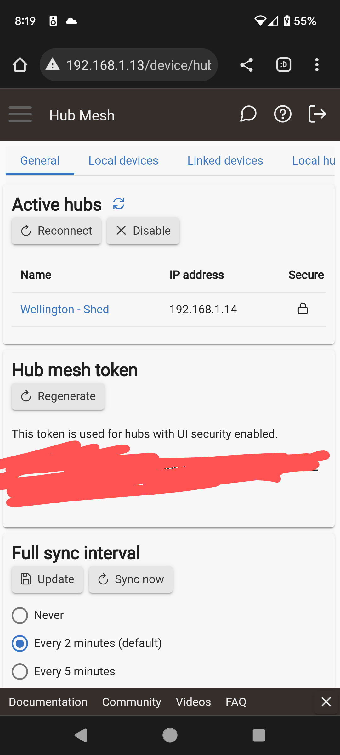

When this happens I can access both hubs by IP without issue, but when I look at one of their settings it thinks the other hub is 169.x when it's clearly not.

It is. Somehow hub 2 thinks hub 1 has that IP, but in my screenshots the IPs I'm using in my browser to show the hub status are both valid IPs.
It seems like once it picks up the bad IP is not smart enough to check again, even on reboots, I have to reconnect on the mesh settings.
