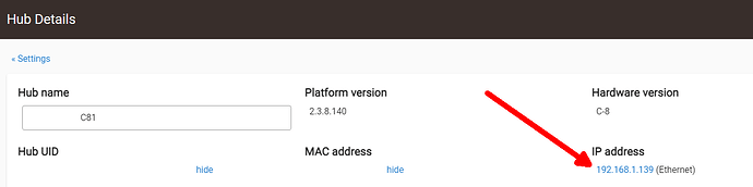

When you log into the hub and look at Hub Details, what does it show for the IP address?
It shows the expected IP address, which is the static IP I have reserved in my router. The only place that shows APIPA is in the active hubs list of hub mesh. So weird.
