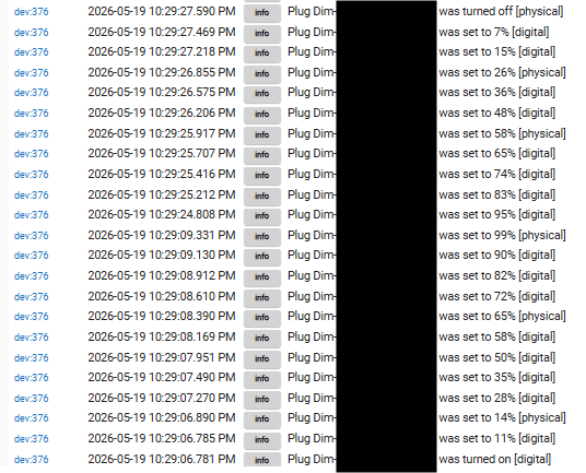

Automation has worked fine for about a year, and the issue seems to correlate with updating to 2.5.0.123. What happens now is the "blinking" is so slow and the hub load gets severe. First the log shows 100's of errors (if I click on the red error, it calls out the Jasco plug dimmer), then an attempt to turn off the light via the plug dimmer (I guess the off part of the blink) fails, then the light is slowly dimmed, so the log looks like the below and then it does the same in reverse...:

Another update: Light is back to blinking verrrry sllllllllloooooooow. I don't yet have the "Hub Load Severe" notification, but instead I got this:
The logs show the light is taking 20+ seconds to go from off to on to off again, in order to "blink":
