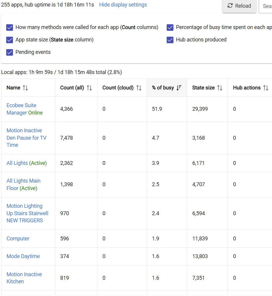

The stats you are showing above don't really point to anything particular. It can be deciving to see ecobee suite at the top of the list with 51% of busy. The reason that is insignificant is that the line right above that table shows the total busy for local apps is 2.8%. So 1.4% for ecobee suite is not much. If you have the ecobee suite polling interval set to 1 min it is probably fine.
The problem is there are many tasks on the hub that don't fall into the tracking provided by the apps/driver stats that hub load does. What are the hub load values when ecobee isn't installed? Ecobee suite may just be the final straw.

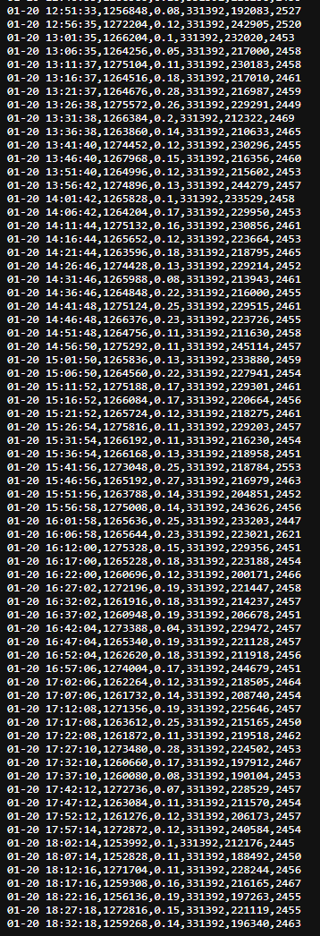

I uninstalled Ecobee Suite about two hours ago. I realize this isn't quite a full report based on the short time frame, but this might give a little insight.
I can't say I understand it, but the numbers don't look too different to me. The reason I'm pointing it to Ecobee Suite is that I can install most any other app, built in or developer and not have an issue. ES seems to be the only integration that causes the error. It was that way on the C7 and now the C-8 Pro.
Interesting.

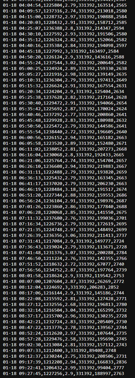

Looking through the to screenshots of the memory and load values some of os memory numbers appear better after removing Ecobee suite. The java numbers dont look any better though and in some cases still go under 100mb
Seems to me like maybe something is comsuming your memory aggressively.
How are you collecting the memory could you adjust it to every 30 seconds. Could be interesting to see how much it is swinging.

Just as a follow up, uninstalled two days ago and worked around the thermostat mode switch. This is the memory and stats from about a day and a half of not running Ecobee Suite.
