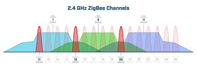

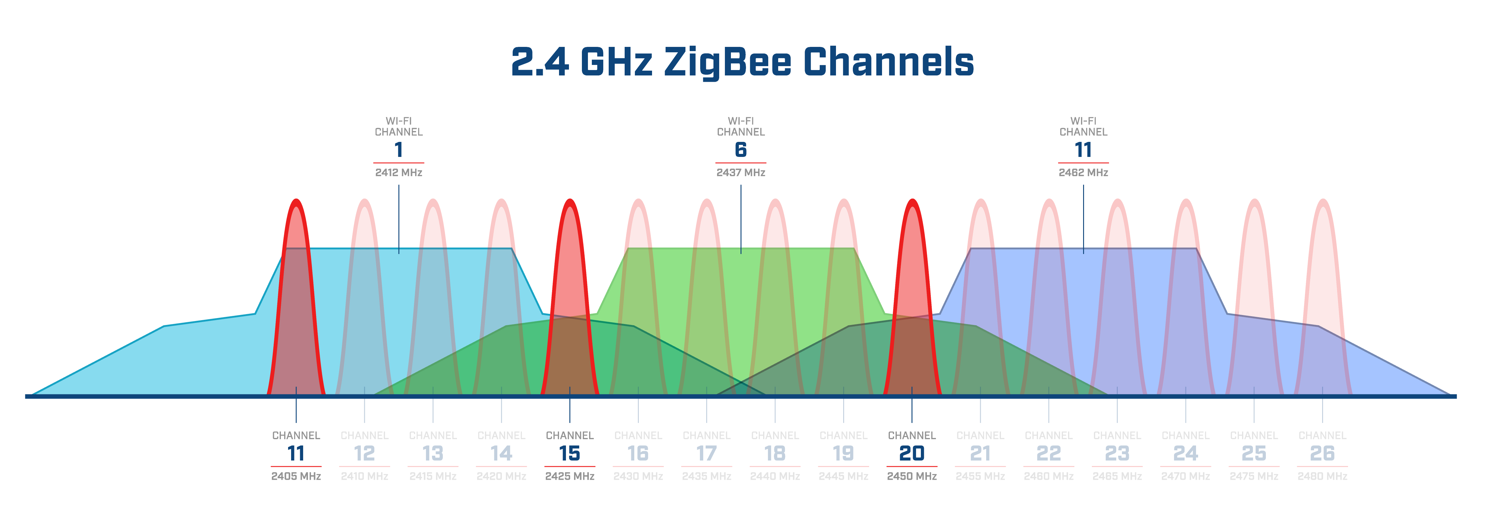

LQI looks good, in/out cost don’t look bad either. Might want to consider 15 or 20 for the Zigbee channel
Ok I just switched to 20, and left the power at 8
Thanks for the help, we will see how that works. Its odd that it works for awhile then just seems to randomly drop, its been good all day since the reboot this morning…
