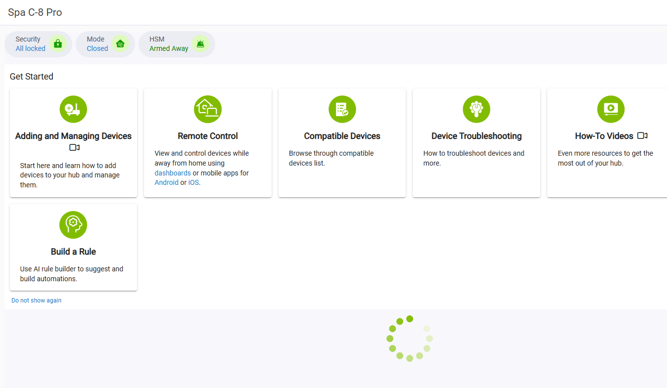

I have 3 C-8 Pro in 3 different locations. I can connect to 2 of the 3. Well 1/2 of the 3rd. I can pull up the dashboard on the 3rd but other then that when I try to go to the device page or app page I only get a spinning wheel. What could be causing this?

Sorry I guess that would help out. It's through a browser. I can connect to the other 2 through same browser but the 3rd just won't pull anything up. I did just try on the app and it's seems to be fine there.
