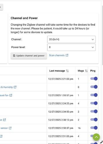

If you haven’t already, i’d enable debug logging on the device, to be sure there aren’t any driver issues contributing to the issue. You can also use the settings > zigbee details page to see if the last message or msgs fields increment.

So look to me the WiFi 2.4 and zigbee is on the same 20 channel . I could be wrong, or is the hub on 14
Zigbee 20 is fine if you are using 2.4ghz wifi channel 1. 2.4ghz wifi channels 6 - 11 could provide some interference .
Your Zigbee is on 20, and your Wifi is on 9, which land RIGHT on top of each other.
Change your Hub to 25 if you prefer to the let router pick its own channel, or change your router to a fixed channel of 1 or 6 if you want to keep the hub on 20.
