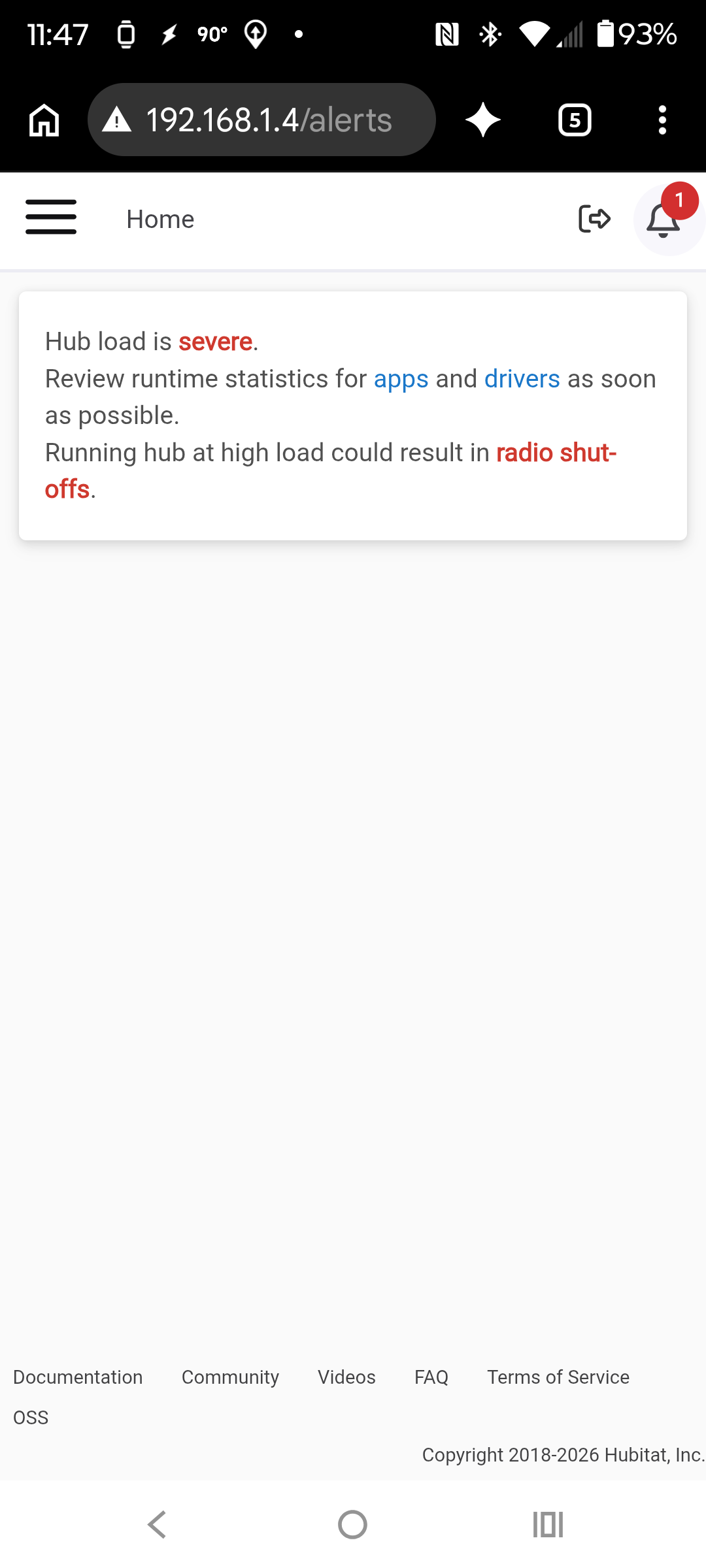

Updated to 2.5.1.182 but continued encountering reboot cpu issues, although hub's browser interface seemed a bit more responsive. High CPU 223% showed on HubInfo app but I did not get that image. As before hub is fine and very responsive after this clears.

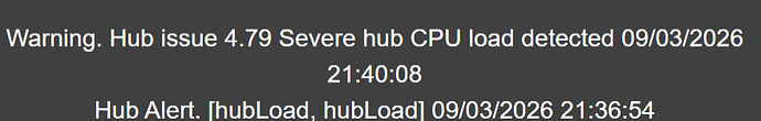

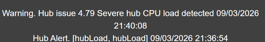

Not sure if this means anything but here goes.
On my hub the issue reports about 8minues and change after reboot.
  1. Reboot 21:28.46 Hubload msg 21:36:54 Time from reboot 8:08

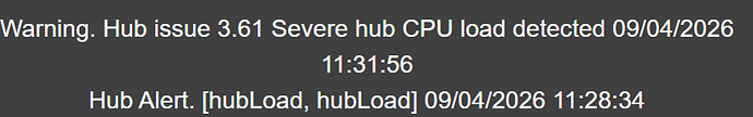

  2. Reboot 11:20:17 Hubload msg 11:28:34 Time from reboot 8:17
