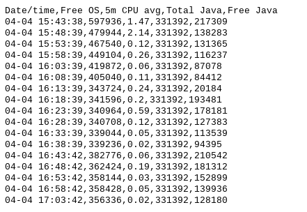

Go to this endpoint:
http://YOUR.HUB.IP/hub/advanced/freeOSMemoryHistory
Scroll as far down as it goes, and post a good chunk of the most recent entries. Could be screenshot or text.

Please see the screenshot below. There was nothing to scroll down. The shot shows everything I got.
Currently I don't get any alerts.
Your free memory is fine now, the alerts you got were probably from before the reboot.
Currently at 356,336

When the update is downloading the memory can drop a lot, it gets freed up when you reboot. So those alerts may have been from low mem before the update but they did not trigger until after it rebooted.
Once and a while things go sideways right after an update as well, and another reboot is needed.
