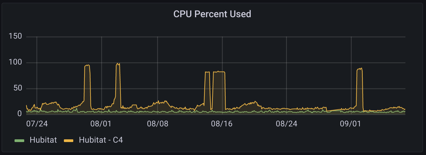

Below are the spikes on my C4 when I was creating a flow for Node-Red to read send UPS data to a virtual driver. Those spikes occured because the Node-Red pallet to access the APC UPS Daemon required sub 13 second refreshes. So ever 12 seconds the flow was processing and sending about 10 updates. I had to update the flow not send updates if the value didn't change and consolidate some of the updates into one update. Ultimately it is stable now, but when doing that with 2 devices It killed the dev hub. It is very easty to create something that works in Node-Red fine and should work but can overwhelm the hub with to many updates at once.
