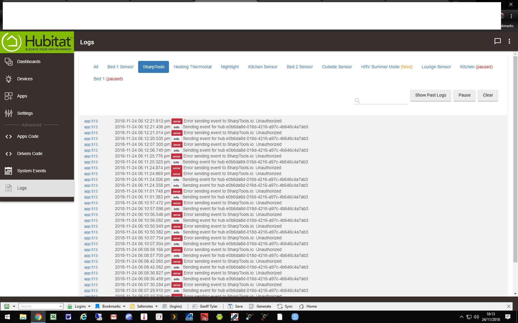

Getting thoroughly fed up with this now. Trying a reboot as we speak. Not sure what else to do. As it's coming back up I'm getting a lot of
Error sending event to SharpTools.io: Unauthorized
in the log. Should I remove the Sharptools app? If I do will that loose all of my Sharptool links at the Sharptools end?
Update. It is back up now but I'm still getting the Sharptool log errors.
Update 2 I've sorted the Sharptools error by logging in again from the Sharptools website.

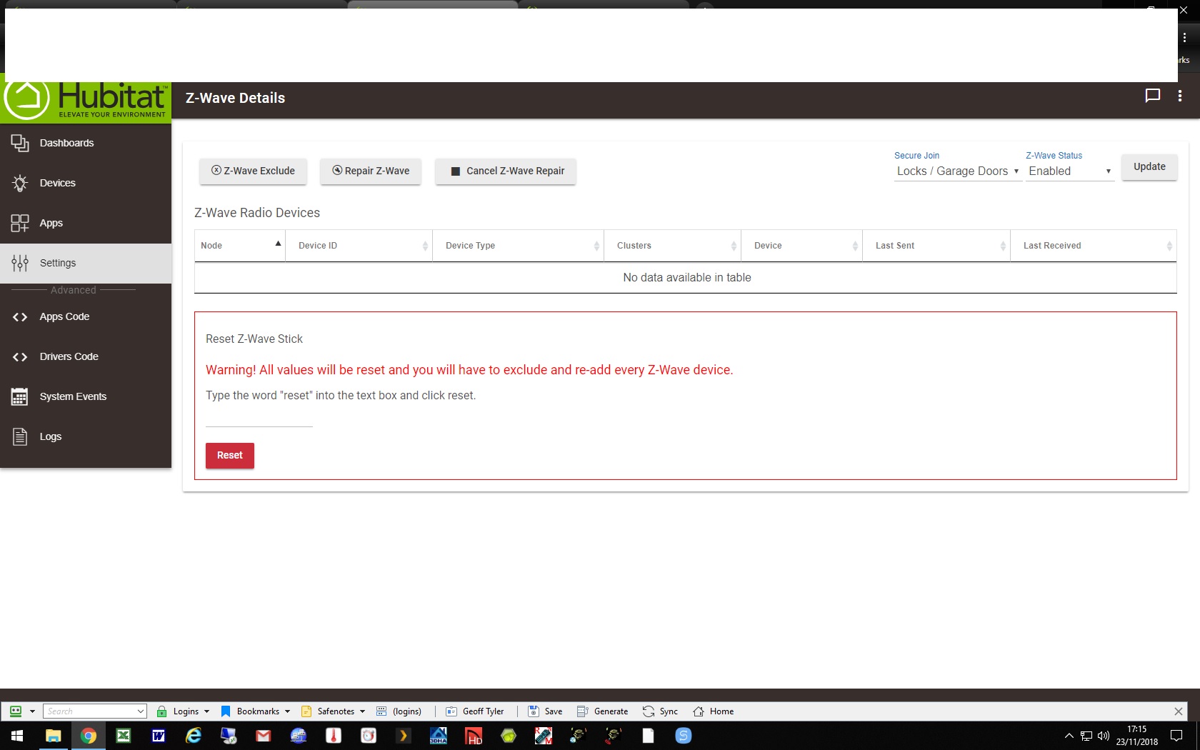

I was trying to add a new zwave switch and it just wouldn't do it.
None of my zwaves devices were responding. I was going to do a 'Repai Zwave' when I noticed...
MY LIST OF ZWAVE RADIO DEVICES IS EMPTY!! There were over 60 devices there yesterday!

Doesn't a backup save the zwave table??
Thinking something may be corrupted, is there a way I can reset the Hubitat to factory and try restoring a backup?
It looks like when this happens to others, a restore fixes it.
Why do I always have to be cutting (bleeding) edge???
Contact @bobbyD for help right away. Donโ€™t continue to make changes. Z-Wave devices are stored in the radio, not in the Hub backup. Thatโ€™s how Z-Wave works, not how Hubitat would like it to be.
