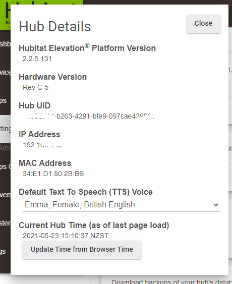

Its up and running perfectly now on V 2.2.5.131 no slowdowns or high CPU load warning fast responsive all good
