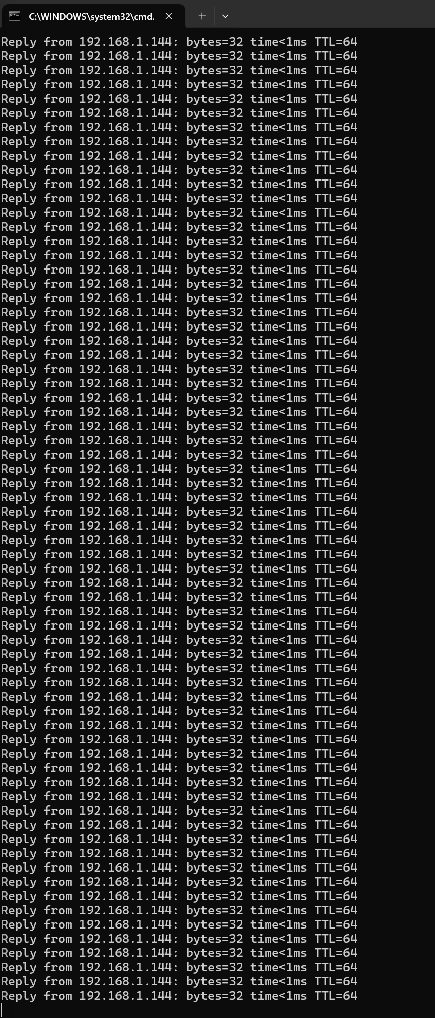

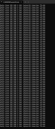

Here's an incident I happened to catch: normal latency, rising / loss, then recovery. (Nothing happening to the network itself.)
Something does not look quite right with the ping results you posted above. Are you running the PING command on a computer connected via Ethernet to the same network as the Hubitat hub? The reason I ask is that I always get much better ping performance than what is shown above. I always get <1ms ping times. You seem to average around 20ms. Something seems not quite right... :thinking:
