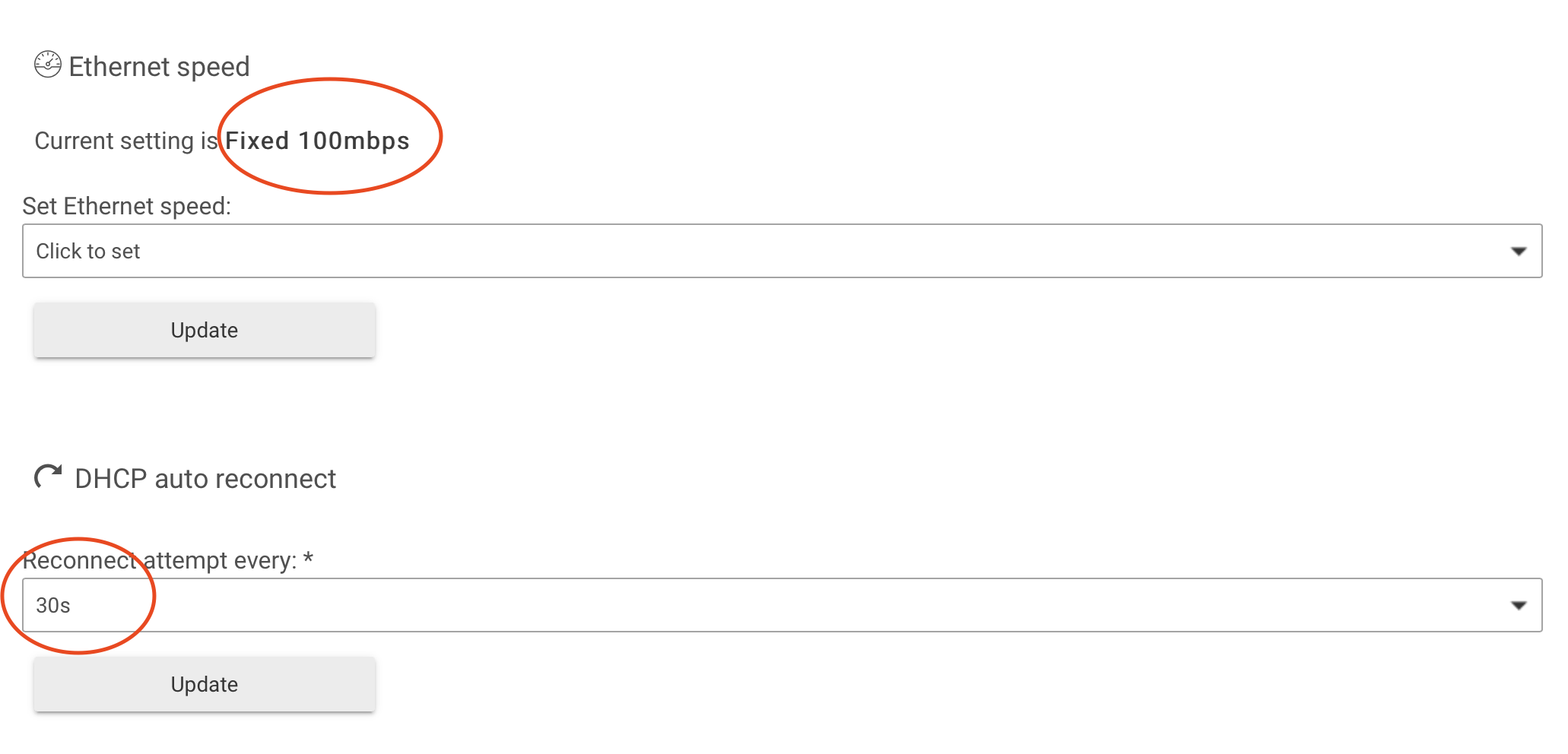

Go to Settings and choose Network Setup. Try changing Ethernet speed to fixed 100mb and DHCP auto-reconnect to every 30 seconds. If Ethernet speed is already set to fixed 100mb you might change it to auto-negotiate.

Per @brad5's suggestion I have toggled the speed to auto negotiated from fixed 100mb and set DHCP reconnect to 30 seconds.

Tentatively this may have fixed it (either the fixed IP or the Ethernet speed?). Will update if not. Thanks all for the suggestions.

I just tried switching the network settings to "fixed 100 mbps" from auto-negotiate.
