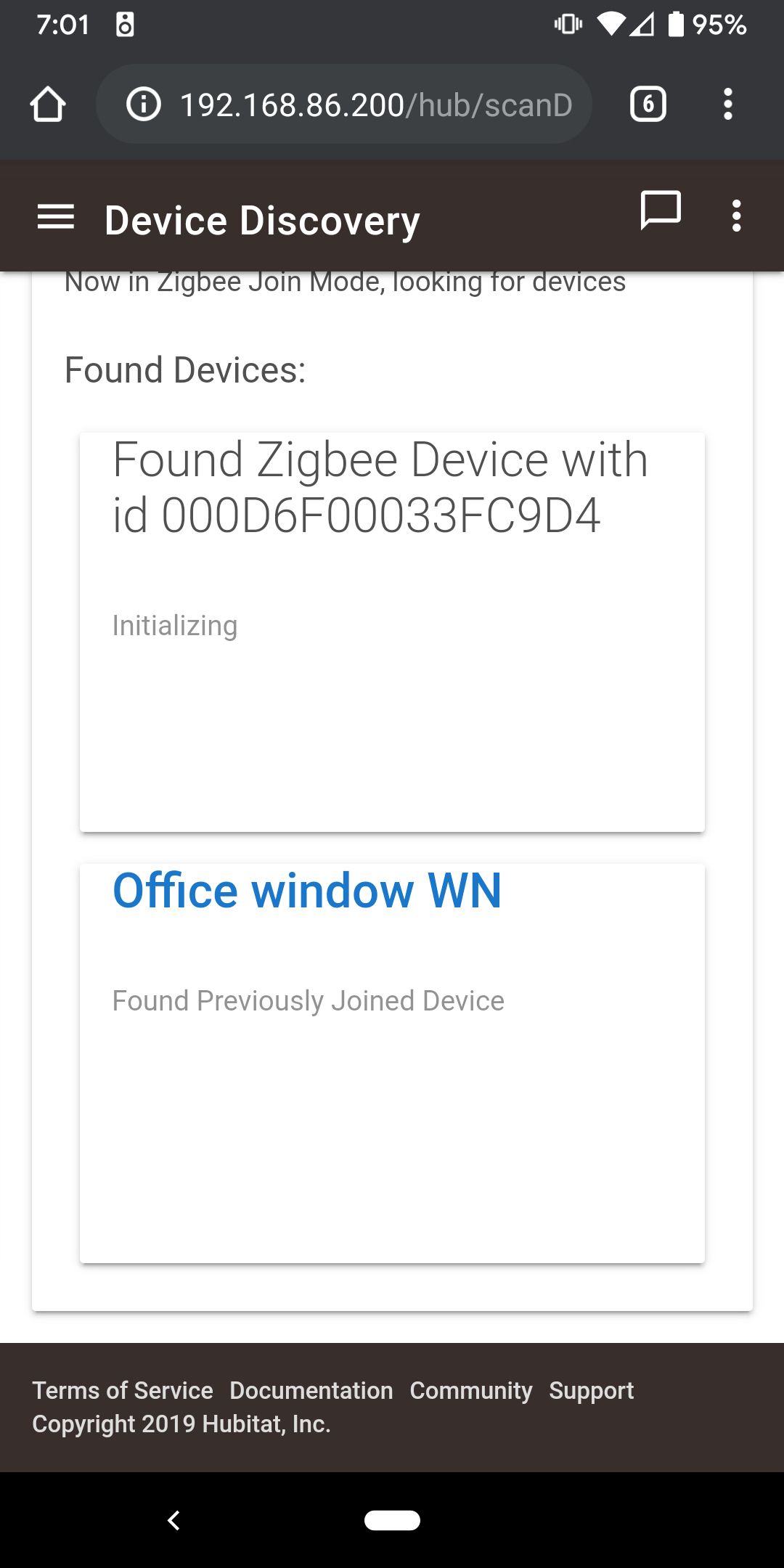

Hub gets stuck on initialize when joining zigbee devices
I have tried to join three different zigbee devices:

Of course when trying to join the iris v1, I used the iris v1 option on the hub. All three do the same thing, they state initializing and never finishes.
After timing out, I check the device list to see if the device joined just in case. None of the devices show.

Iris v1 still stuck on initialing
I'm going to try more devices but just in case I pulled the battery from the Iris fob.
One Iris v1 contact sensor gets stuck on initialing and the other won't configure correctly to work.
[Edit] both will flash the green led indefinitely

I've also hat the same initialising problem and opened another joining process at the same time, the second instance joining immediately, then just stopped the first
I would be interested to know what actually happens with the HE processes when that happens. Does a second initialize process happen?? @mike.maxwell would you ba able to comment.
This was happening as well. When it just appeared to timeout. I would refresh the page and then two instances would show. When checking the device list though, the new listing wouldn't work.
From what I know, there is only one join process running at a time. Hubitat did change a bit when it comes to the countdown timer. Yes, it actively looks for new devices for 45 seconds but it will continue to try to join a device that hasn’t finished the pairing process beyond that 45 seconds. That’s why devices might finish after the countdown timer is done.
In regard to the second window, I am not sure if that restarts the join process or just piggybacks on the existing one
