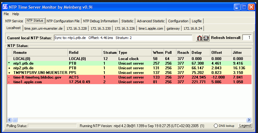

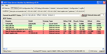

I then verified my NTP server was actually alive and well using meinberg app:
this lets me check settings and verify my server is there and functional.
