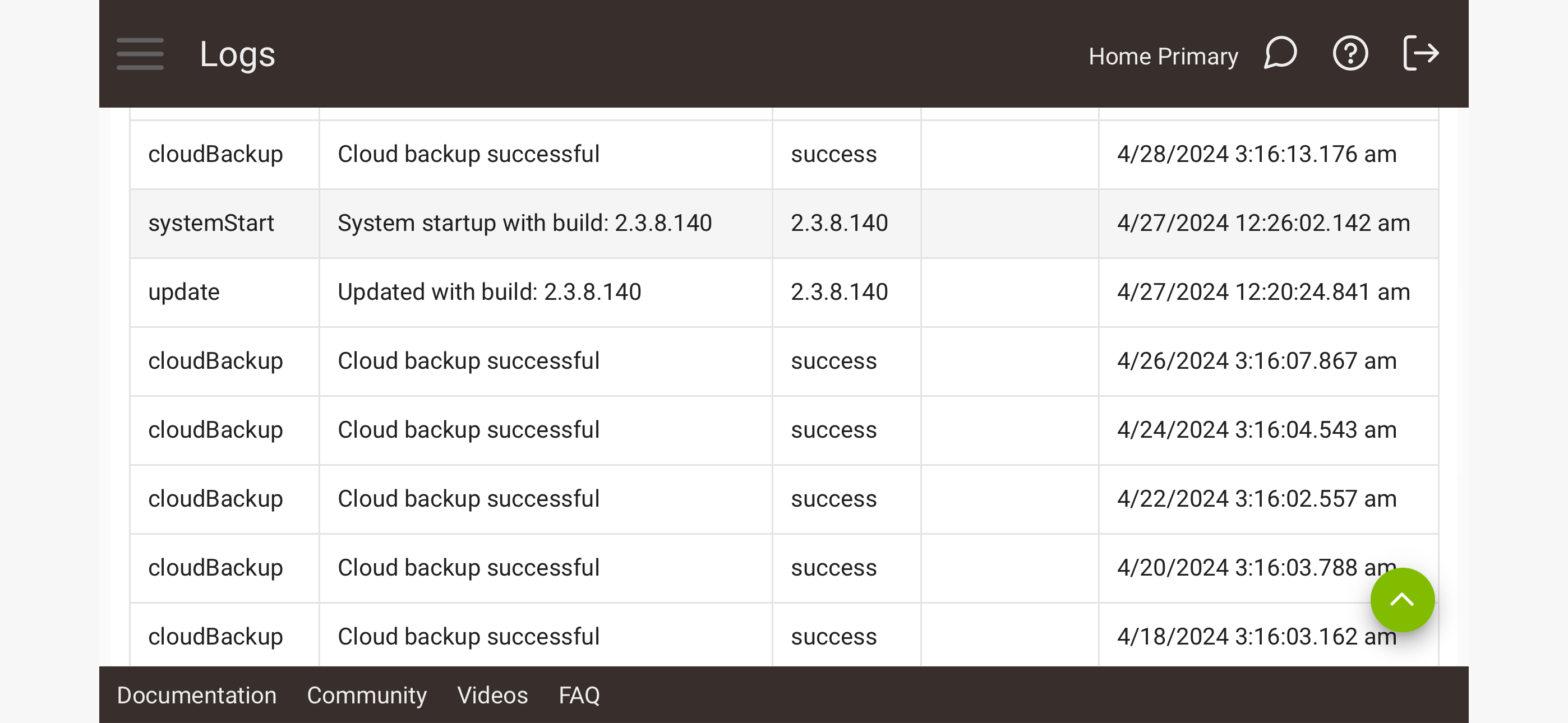

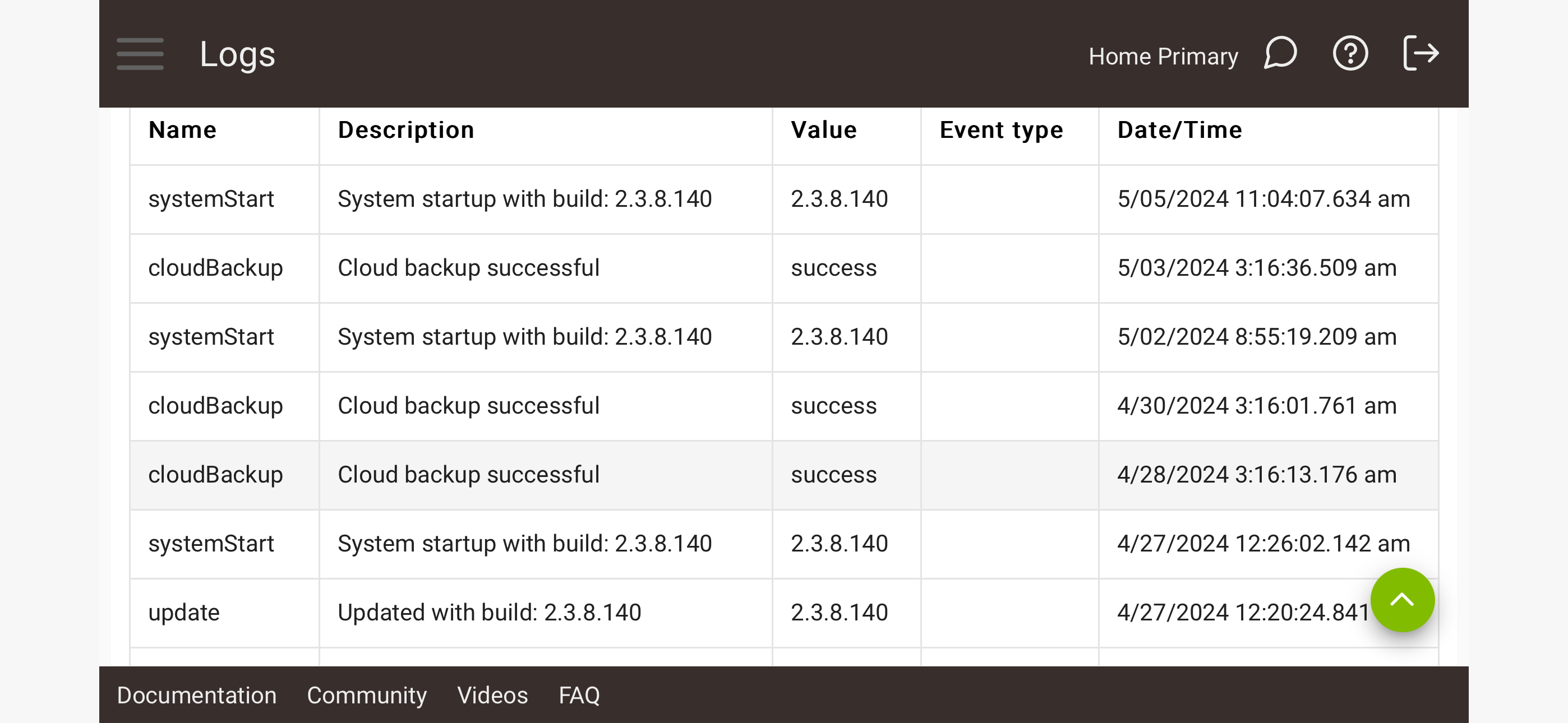

Just had another crash on my hub last night, the first time was 3 days ago where I woke up to the blue light. I thought maybe it was just a once off however it did appear to happen around 3am just when the cloud backup would run. This morning I woke up again to the web interface being down but the diagnostics tool was available. I rebooted from diagnostics and eveyrhting is back running again. I’ve not added any new devices for some time and just recently updated to the latest version. I’m running. A C8 hub (not pro) ,i’ve attached some logs from the hub and as you can see system startup just after a backup (manual reboot)

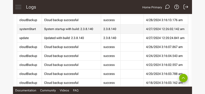

It looks to me from the logs that the last cloud backup was on 5/3 @ 3 am, a couple days ago. Maybe it's not related to the cloud backup.
Maybe poke around in logs and try to figure out approx when it went off line?

Yep you are correct which is the same time it crashed the last time. You can see the is being around 3am backup complete and a few hours later me rebooting the hub. Same thing happened 3 days ago.
It's looking to me like the 3 am backup was a DAY + a few hours.
Hmmmm actually you are right. Ok I clearly need to do some digging. I’ll check the logs when I get home I have one other thing running a 3 which might be the problem. I’ll report back , thanks for checking not sure how I missed that one.

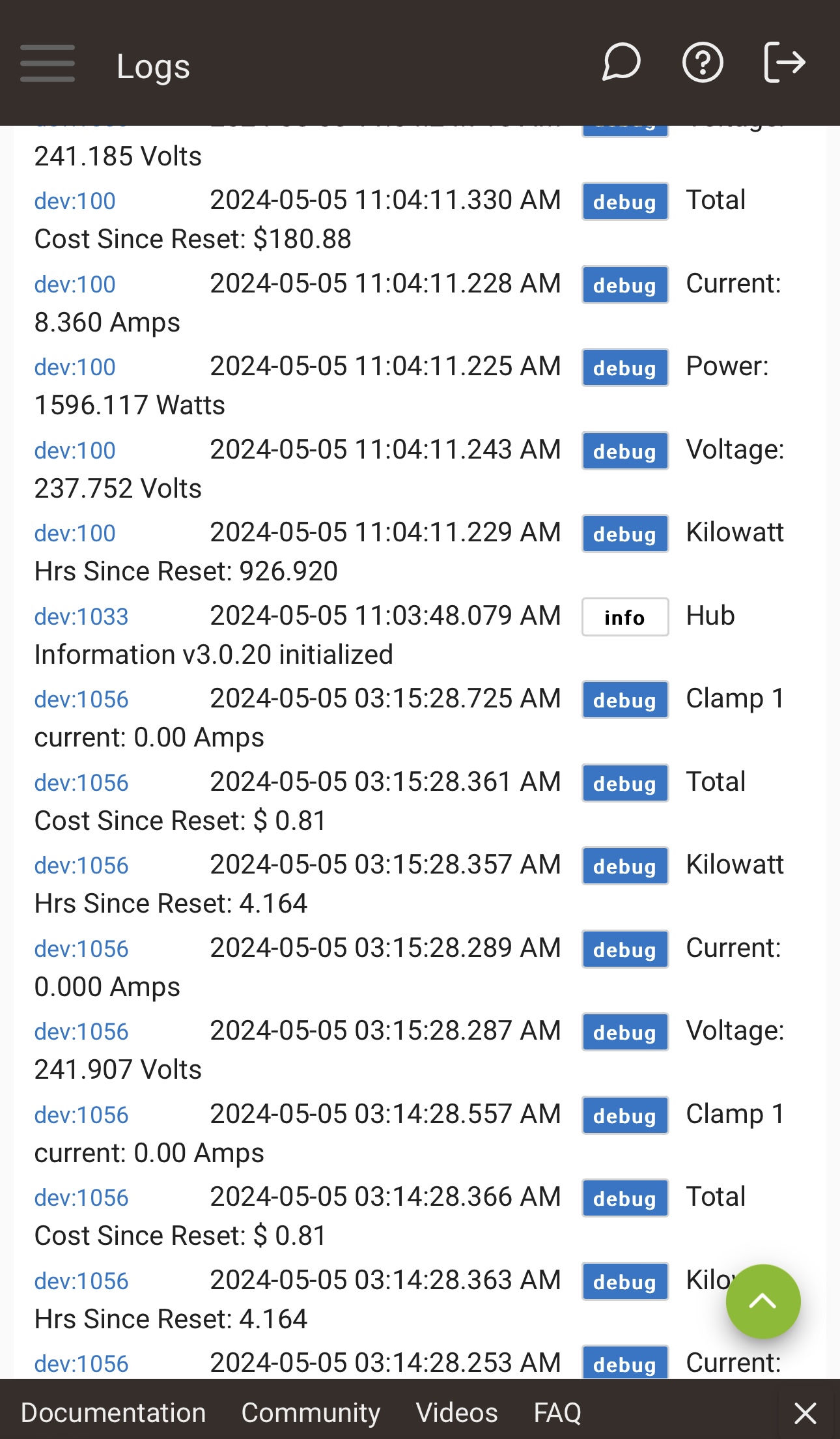

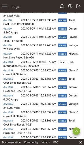

Ok hub reset, logs cleared and local backup restored. Let’s see this goes. One thing I noted the cloud backup was set to run at 3:15am and the last log in the local log database before a reload is attached. As you can see it stopped in and around the cloud backup time. I’ve reset the backup time to run every day at 4:30am to see if the hub will crash again at that time. (Hopefully not)
