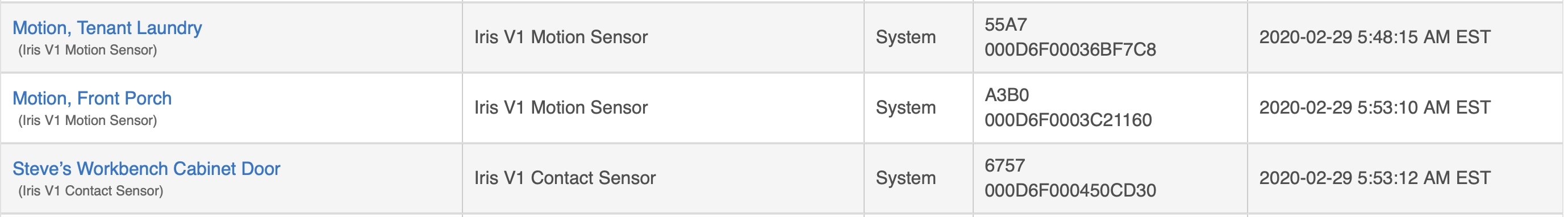

Here is one supporting piece of information on the theory that the hub slowdowns/crashes are causing battery life to fall off a cliff..
All of my Iris v1 devices have been experiencing drastically reduced battery life since late last fall...
Here are three of the that all fell offline with dead batteries on the same day, two of them at almost exactly the same time.
Note the time.. That's within the early morning window of time where my hubs (and others) have been crashing every few nights.
