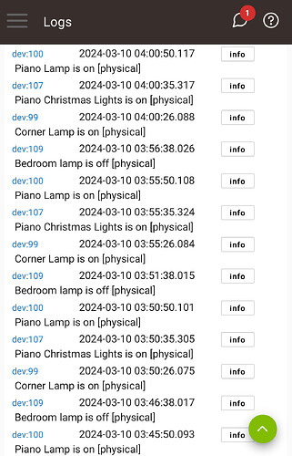

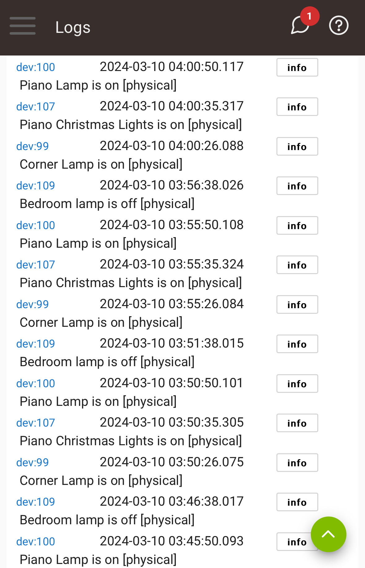

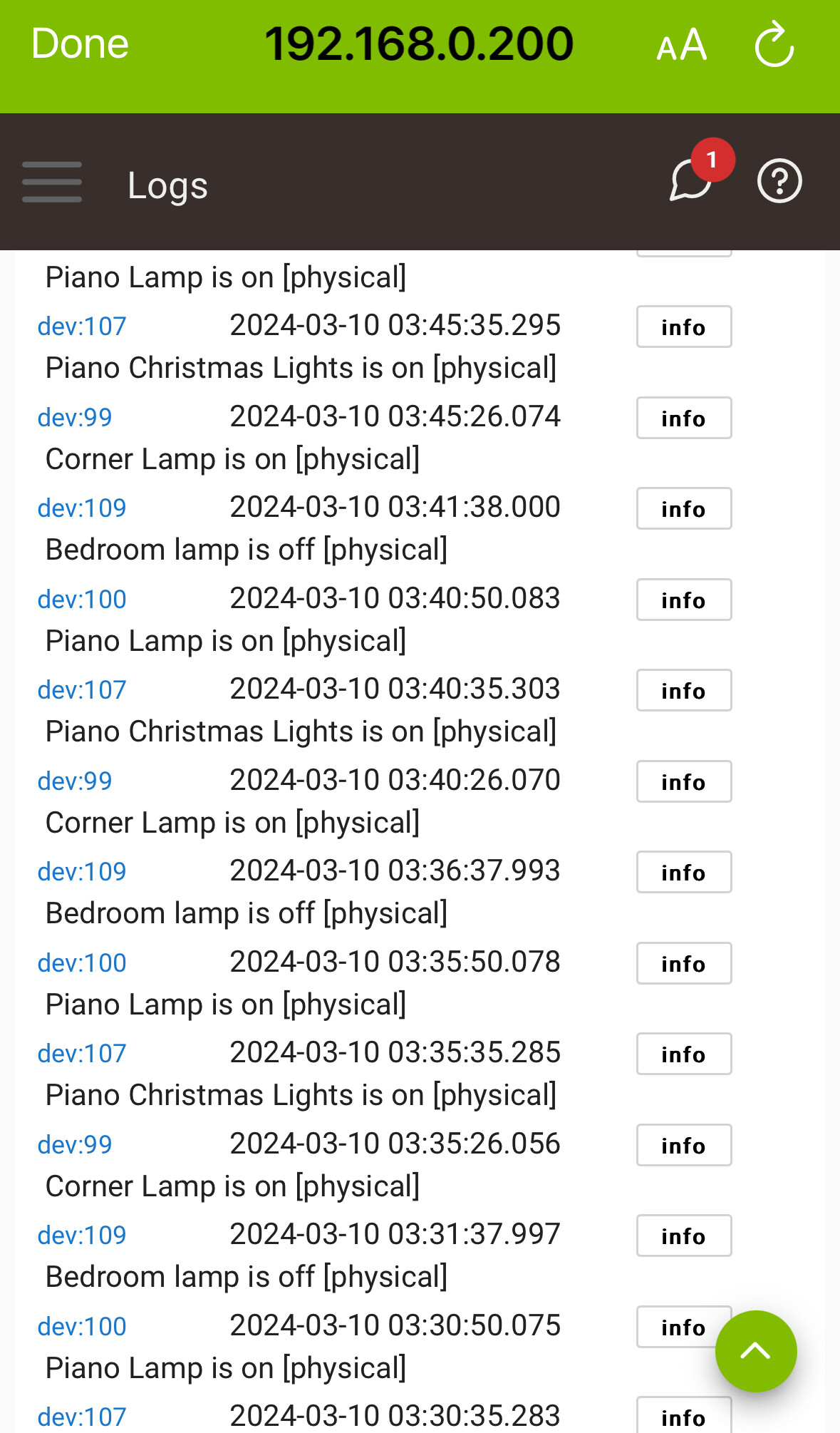

Here are my logs including the last action before it froze.
Any ideas? My wife is starting to resent my “sometimes” smart house haha.
If there is anything I could be doing better to help debug, please let me know.. I’m pretty new to hubitat as a whole.
