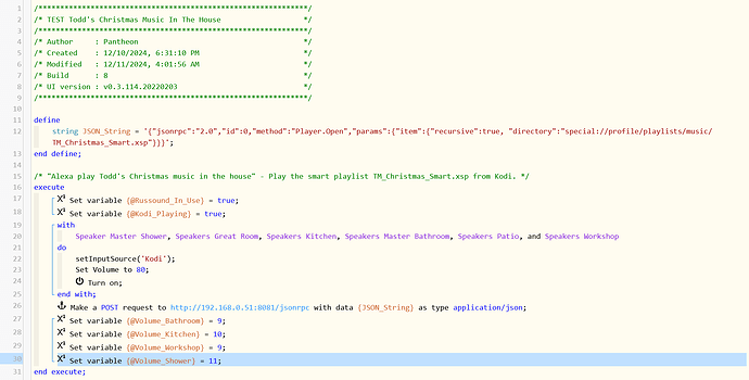

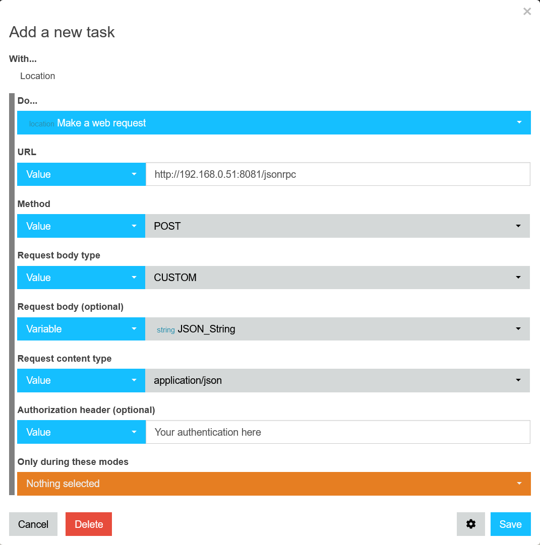

This is how I used RM to mimic a webcore piston POST command to play a playlist off my Kodi music server. My Kodi requires authorization.
My Original webcore piston

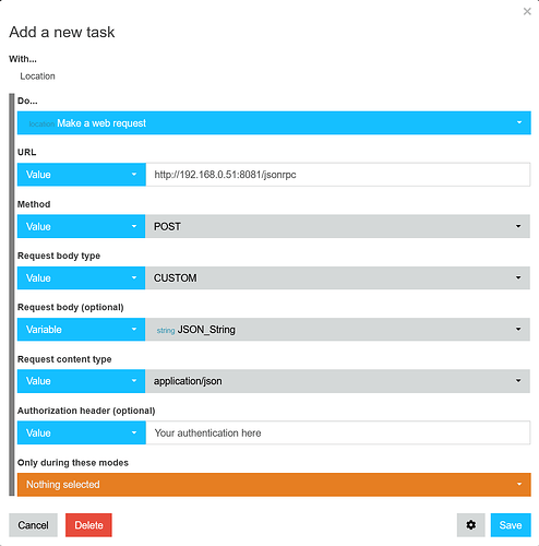

RM settings for the same Kodi playlist
