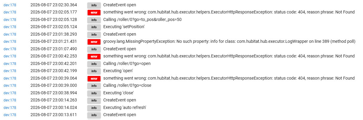

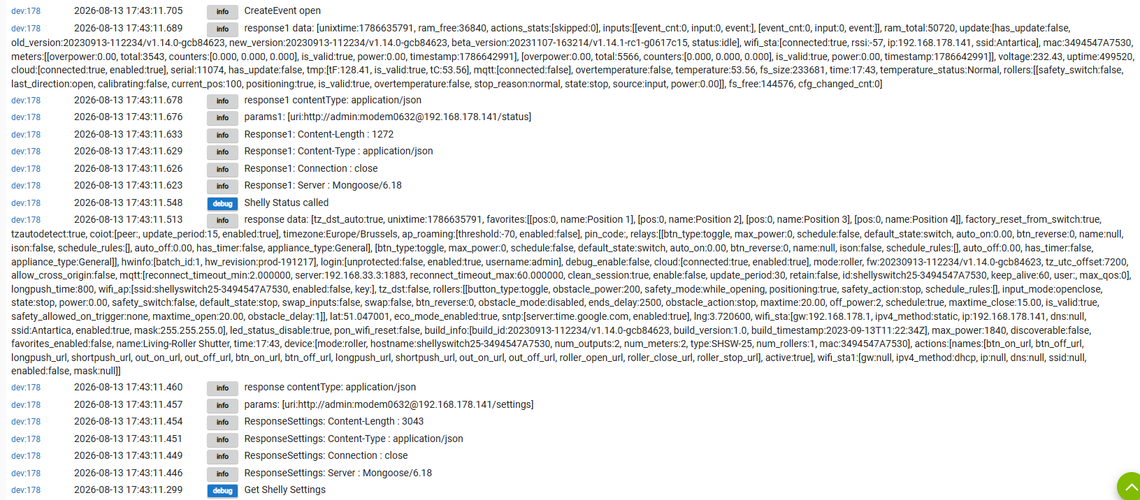

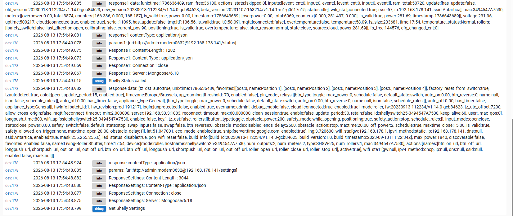

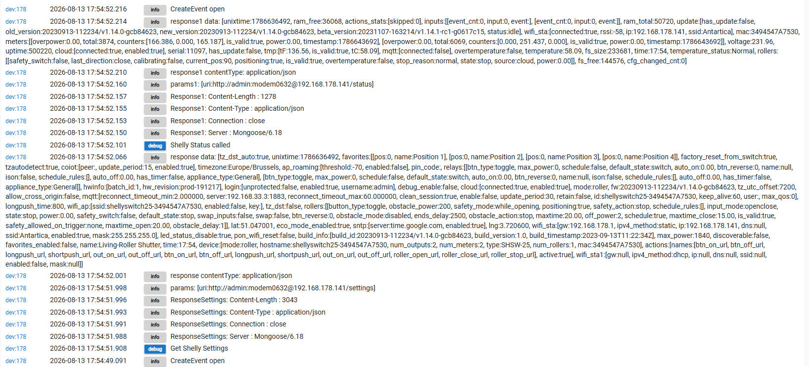

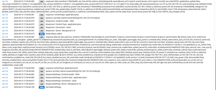

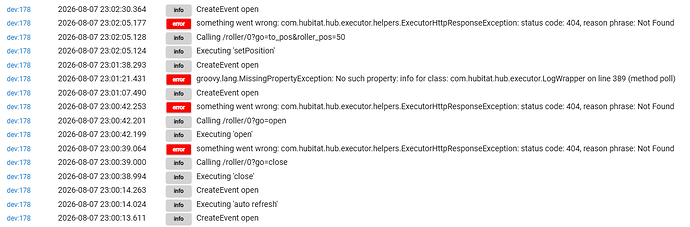

Hi @gopher.ny still not OK
Hope those log's can help:-)
this is when I close to position 80
This when I do a poll (don't know if it was supported)
this when I do a refresh
This is when I set level 80
When I close
When I use the shelly app to change the position, the status is updated in Hubitat. This is to position 90 using the Shelly app
This is helpful, thank you. Can you send me a link to the driver code as well?
