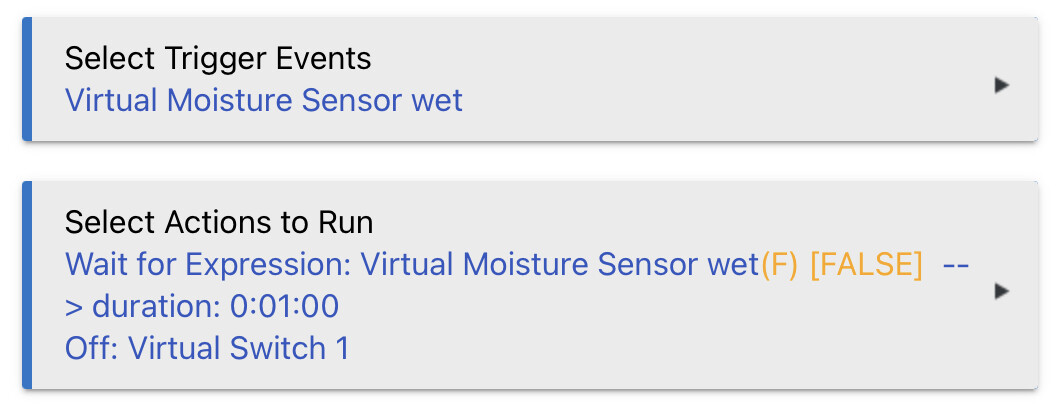

You could use Rule Machine to do this:

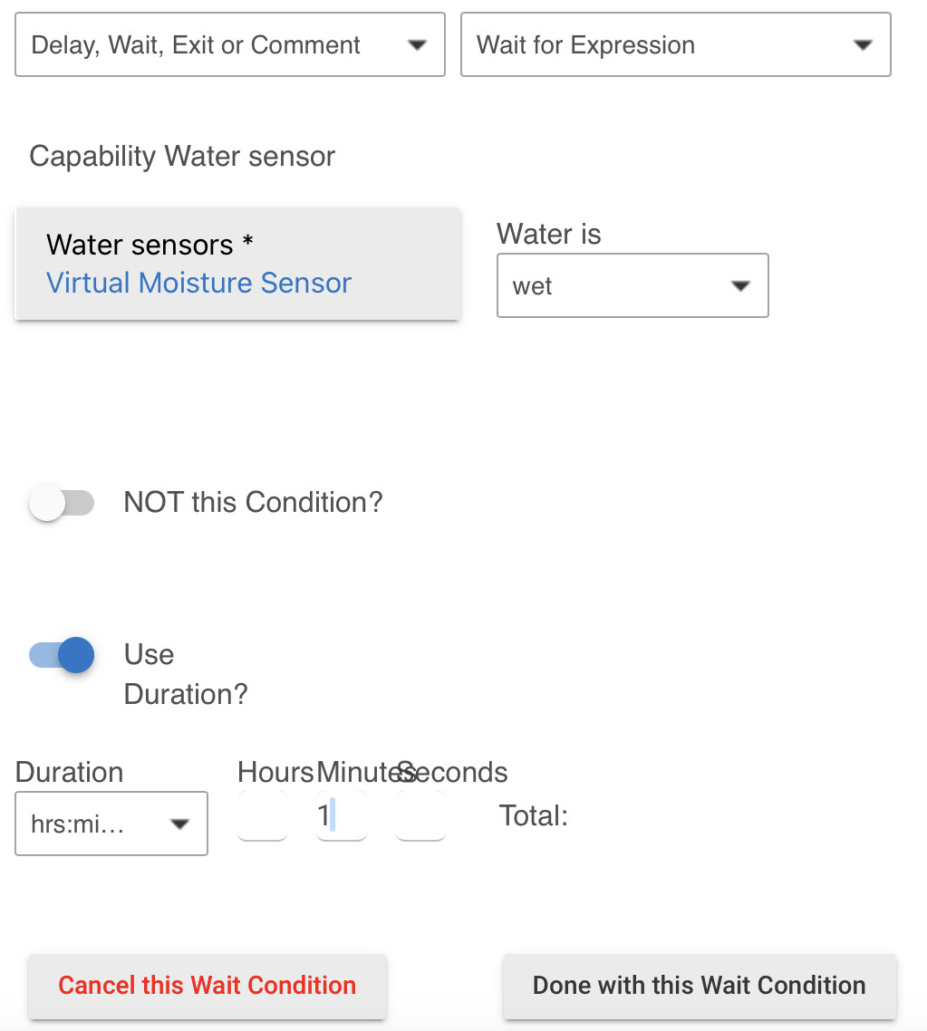

Here’s how to setup the Wait for Expression action:
