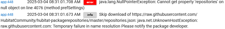

Getting something similarly weird here on 2 of my 3 hubs:
Working fine on the 3rd hub. Tagging @csteele
"Unknown Host Exception" -- indicates there's no such place as raw.githubusercontent.com

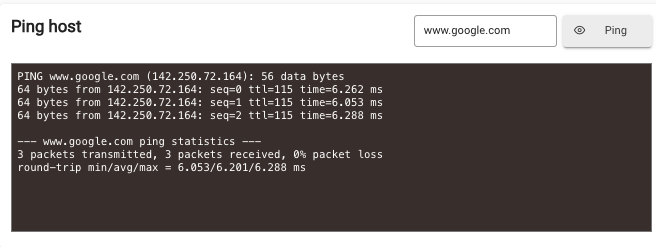

That's clearly impossible, so there's two possible reasons.. 1) github made a typo while modifying their DNS system. Not really likely since "working fine on 3rd hub" 2) the hub does not have DNS working properly. This is the most likely. Go to Settings: Network Setup: Network Test (at the top) and then Ping somewhere by name. If you get results, DNS is working, if not, fix DNS on your hub.
Above is what working looks like..

That did it - somehow, two of my hubs simultaneously forgot they had static IP addresses. Weird. Thanks!
