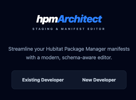

I suggest you checkout my HPM web based tool:
Along with it’s associated Topic:
