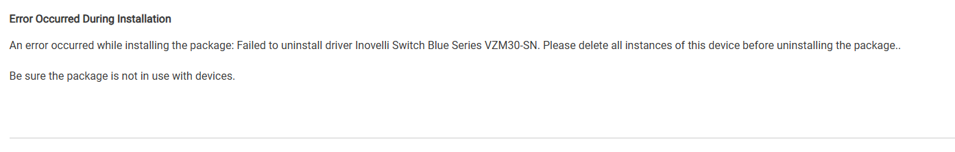

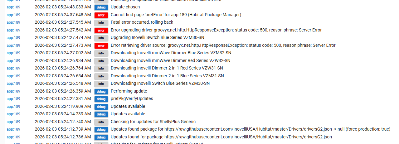

I have 3 Inovelli switches, Red 2-1 VZW31 and a couple Blue 2-1 VZM31-SN, both are using the gen 2 drivers (see below) from HPM. I don't recall ever downloading the VZSM30-SN or VZW32-SN/VZM32-SN drivers.
I tried to uninstall both 30 & 32 version of the drivers, get an error that VZM30-SN driver is in use (its not), same results of I just try to uninstal the 32-SN versions. I've repaired the drivers via HPM, all works, but then updates fail. What am I doing wrong?

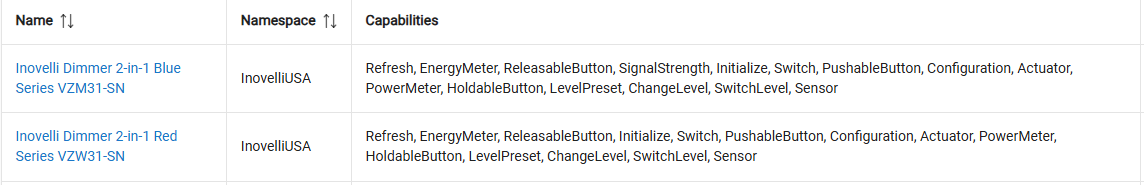

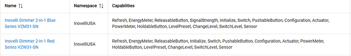

Ended up solving my own issue. I just copied the VZM30 and VZW32-SN/VZM32-SN driver links from inovelli into the driver page of hubitat. matched up in HPM, updated, then uninstalled the 3 I did not need. all good.
