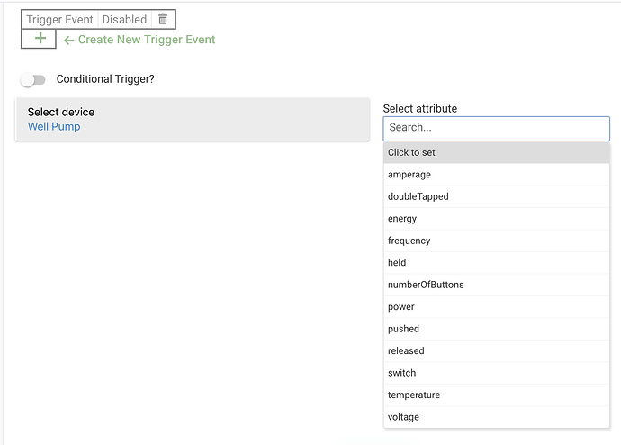

Use custom attribute in trigger?
Are you saying you see a temperature attribute on the parent device, and it gets updated from the board, but you just cannot find it to make a rule?
I didn't think that the built-in driver creates a temperature attribute, unless it was updated or something. Does the parent device also show as having the temperature capability, by showing up under Temperature Sensors in Rule Machine?
You should just be able to choose it as a custom attribute in RM if it is not listed as a temp sensor, if the temperature attribute is there in the parent, even if the driver does not have the temperature measurement capability.

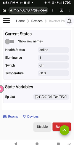

Yes, the parent device shows the actual temp, not the child devices.
And correct on the rule machine does not list it when I go to select the temp devices. (The parent device does not show up under temperature devices.)

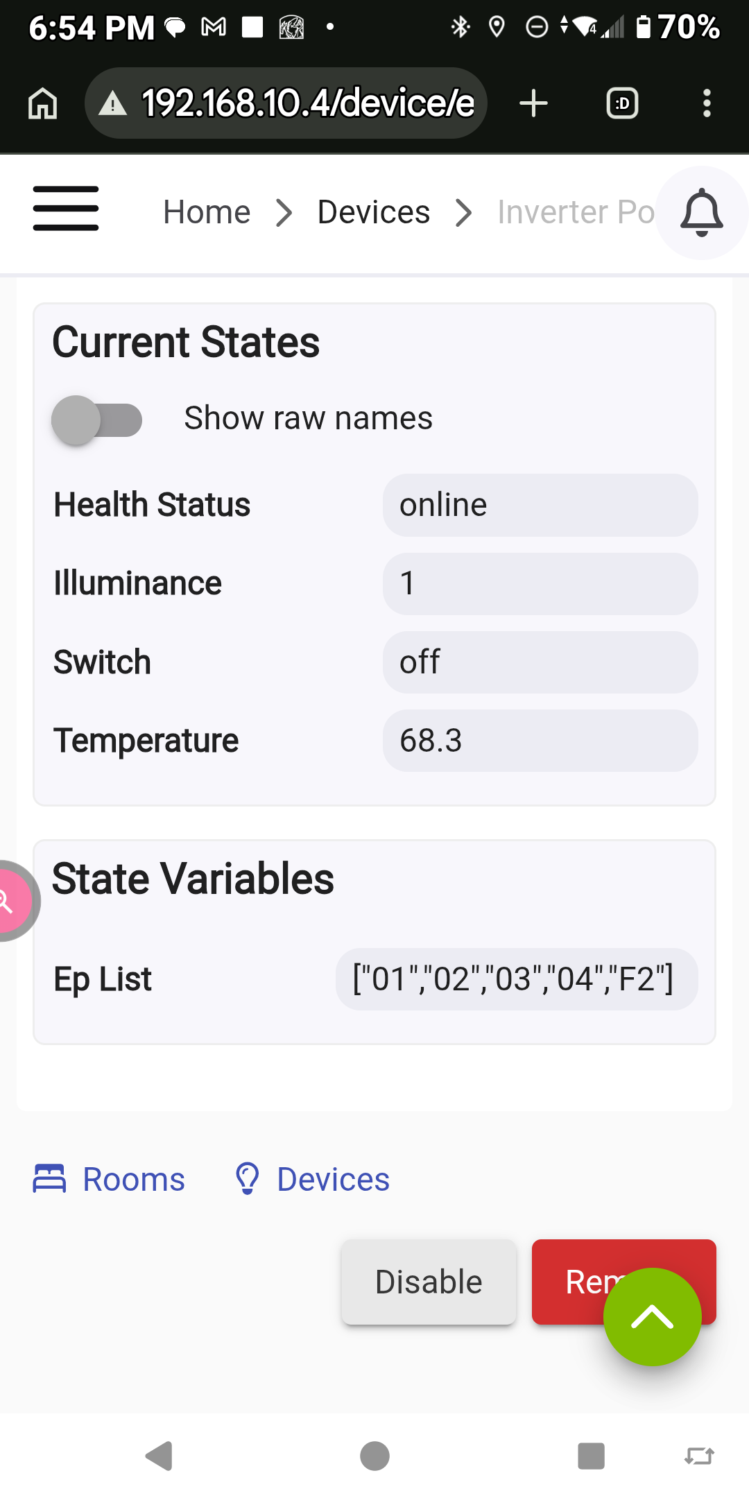

Under the parent device it says EP list and (01","02","03","04","F2)
I don't know if that helps.
Hey guys, I just noticed something. Even though the screenshot shows 68.3, it never changes so I believe it is useless to continue down this line of questions.
