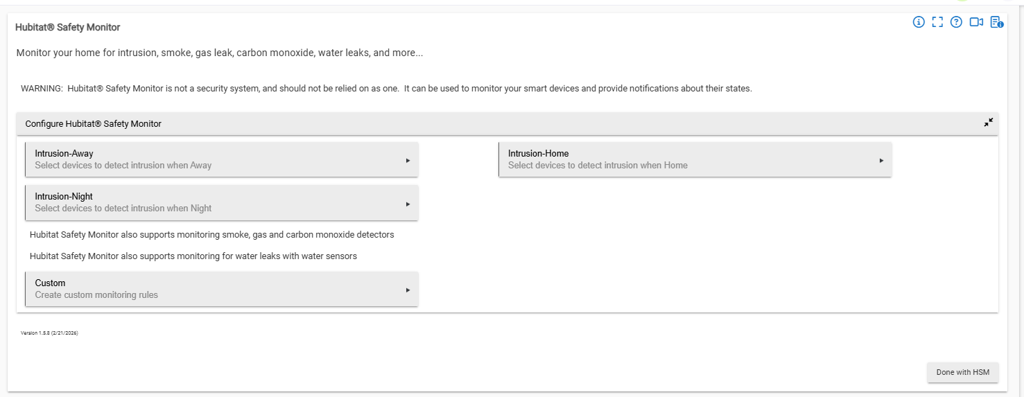

So I in looking at post and documentation, there should be a section in HSM for water detection, but I do not see it in my app. Do I need to install something else? I am not sure even how to start now adding my sensors
my app

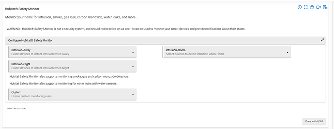

documentation

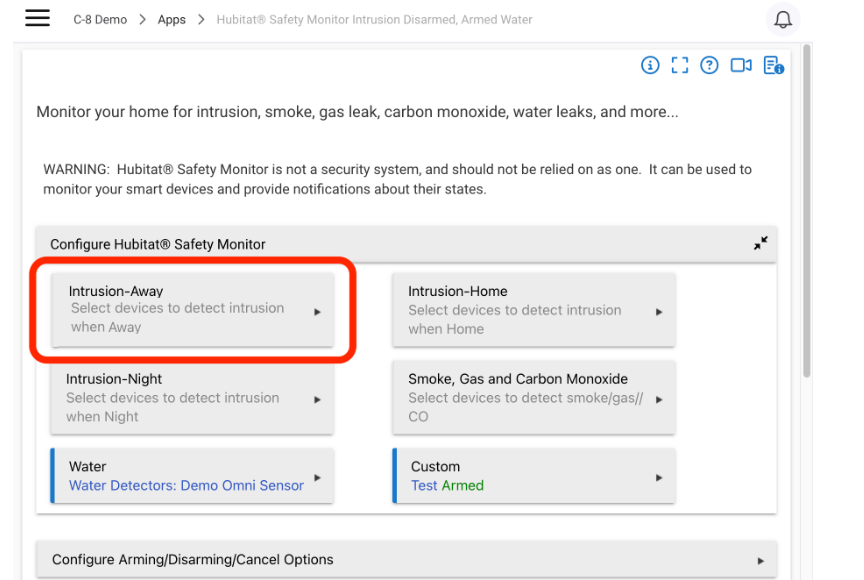

According to your screenshot, you have no water leak sensors paired to your hub, same thing for smoke/CO/gas leak sensors.
Look at the text between “intrusion-night” and “custom” in your screenshot. It’s telling you that HSM supports those types of sensors, but if there are none paired to your hub then HSM can’t be setup to alert for those events.
