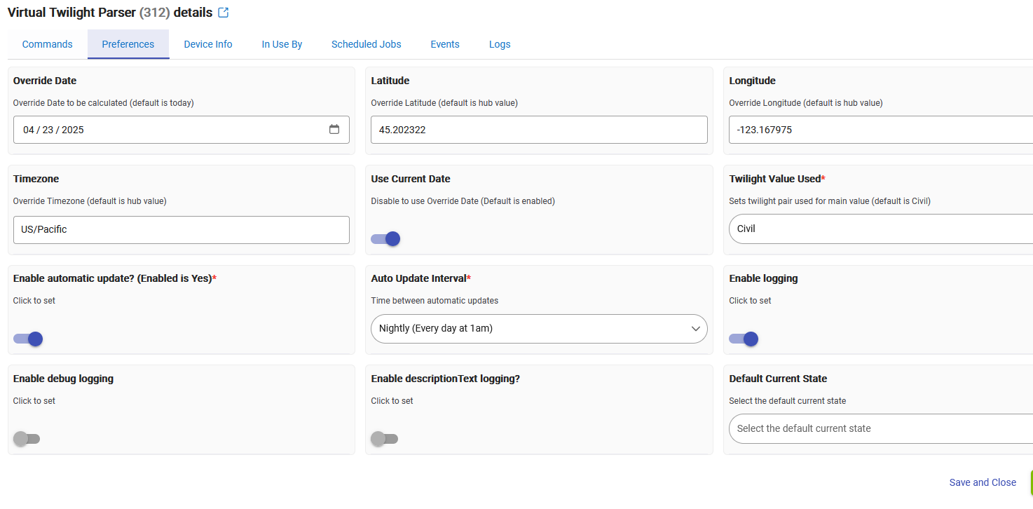

With help from the community , I wrote a personal 'Twilight Parser' driver I use to accurately track outdoor lights between actual SR/SS and twilight.
the call to Sunrise-sunset.org works very nicely and allows you to feed a date. I have to do this since HE pulls SR/SS from 30 miles away (Salem, OR) which is 3-7 mins off always. Us Farm Country people take SR/SS seriously.
