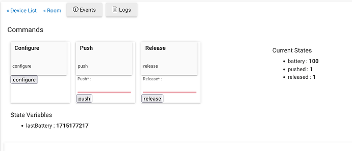

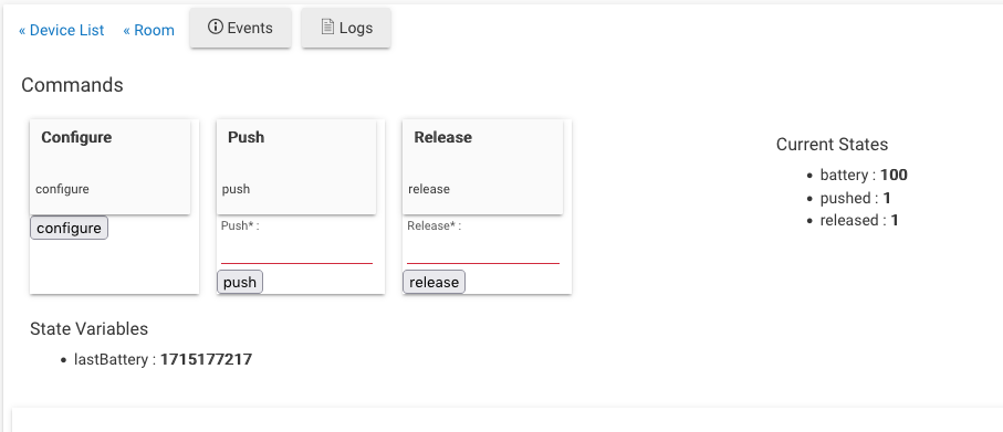

The device is in the devicelist (thats why I bought it) and works fine as far as only using push for 1 one button. In the device-page I see only ¨Push¨ and ¨Release¨ button. When trying to set up a Basic Button Controller I do not get more then ¨Push¨ and ¨Release¨ to work with.

First one from the Device page:

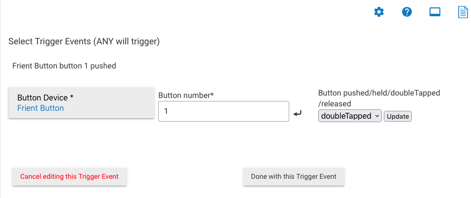

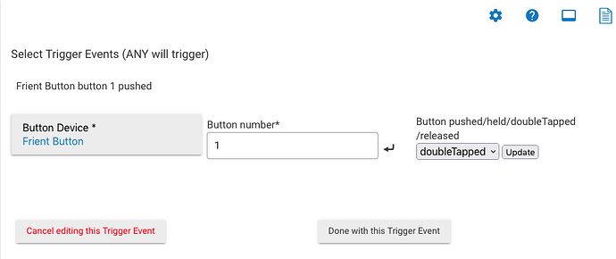

And one from the App page:
So I tried Rule Machine to get more options. There I could choose ¨Double Tapped¨and ¨Hold¨ but nothing happens whit both options. Only ¨Push¨ seems to work here. What am I doing wrong?
Does the device actually support these options? If not, the driver will not expose these capabilities, and most apps will see that and not offer things you cannot use.
Some things, like pushing twice or more, may be doable with an automation on the hub. Others, like the difference between a plain push and a hold, are best done with a feature on the device (though you can also make a somewhat fragile workaround on the hub if the device offers push and release only -- and does so for every event -- by calculating the time difference on release or something similar).
