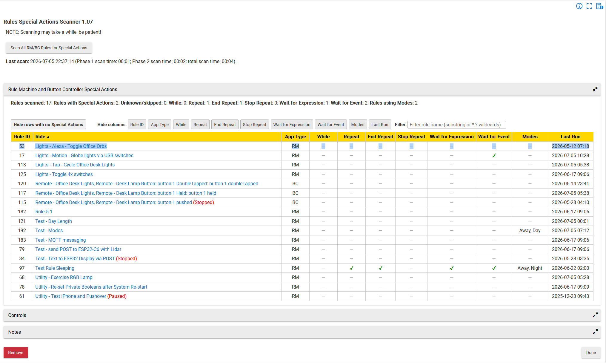

EDIT: screenshot -
I don’t use modes much, just created a couple of rules for testing purposes, so I invite your feedback as to whether the app in post #4 seems to work for you.
John, your app worked great for me for modes (which, for me, are all “sun-based”, dividing the day into DAWN, DAY, DUSK, EVENING, and NIGHT, with many other rules acting accordingly).
While testing it, I did note something interesting: there’s an awful lot of undeleted cruft stored in many of my rules. As part of this, rules which no longer use Repeated Actions still have keywords in them that your app picks up.

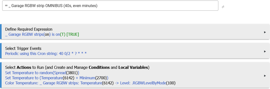

An example: here’s one of my current rules…
…and, from that rule’s “Application State” list:
The Repeats and Cancel were removed from the rule when “command retry” was added to devices; amusingly, the “Front Foyer stairs” were in a previous house, which we left over 3 years ago, when I copied this rule to handle the strips under the stairs in our current garage.

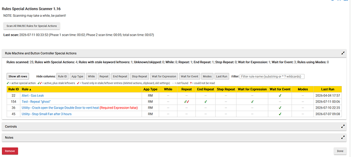

Try v. 1.09, which filters key word “hits” found only in stale/leftover entries (deleted actions, clipboard, old settings) so that they are flagged by a red check mark. This might help if you ever create a “de-crufter”.
See post #4 for the link (and all versions have an importUrl).

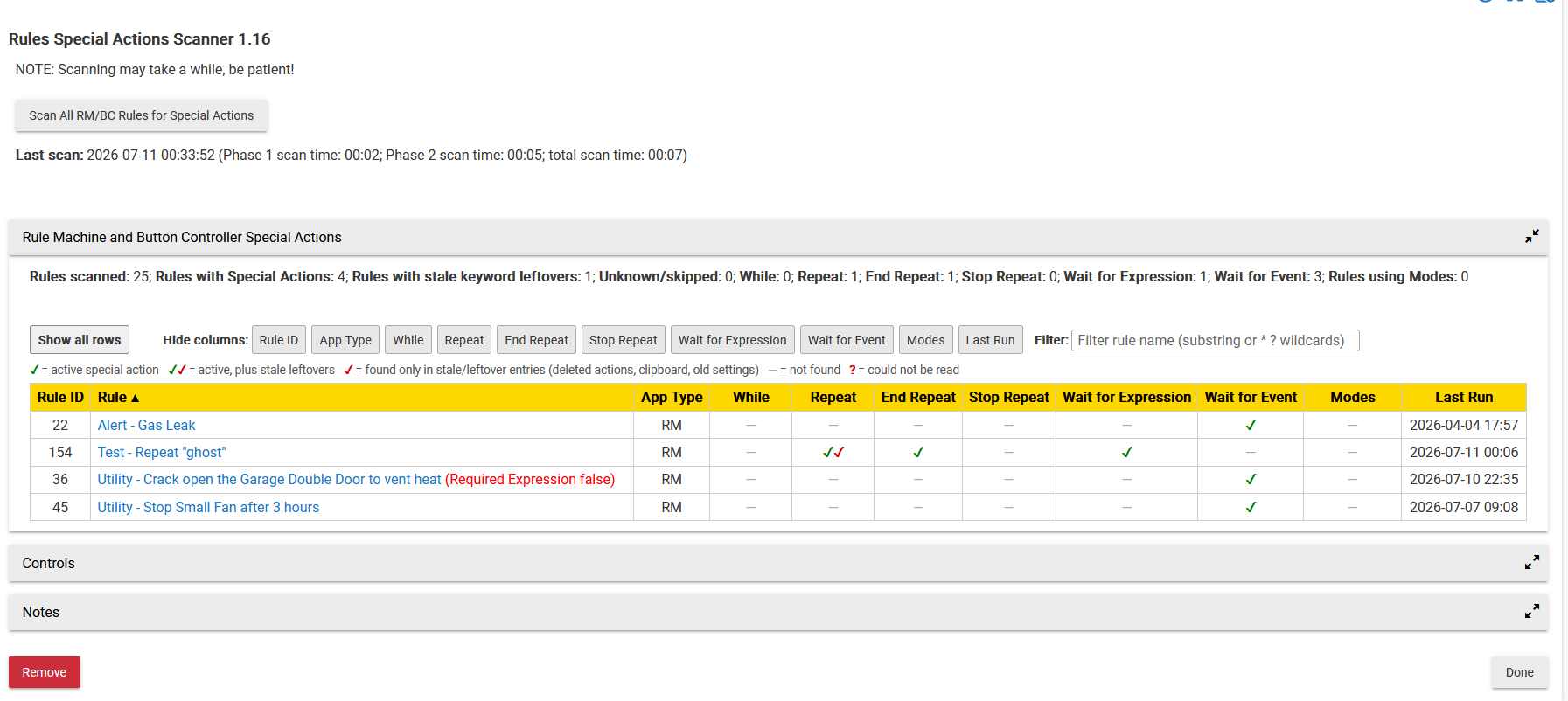

The link in post #4 and below is now to v. 1.16 that differentiates between a key word (e.g., “Repeat”) appearing in an action versus appearing in stale rule “cruft”.
https://github.com/JohnFLand/Rules-Special-Actions-Scanner/tree/main
