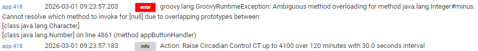

I cannot figure out what caused the error below. Any ideas/advices are welcomed. Thank you.

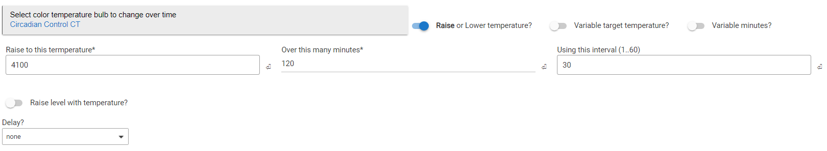

I am setting global variables (1 for CT, 1 for Level) that change based on sunset/sunrise timing. My other lights will update CT and Level based on those variables. Currently, only the Level rule works for me
Your screenshot doesn't show global variables, but it does show hub variables (if you are new, yes, they are different :slight_smile: ). However, your rule cannot use a hub variable in the location shown. Since that's not it, I assume you mean that you're using the variable connector? If so, that is a device, and the fact that it's using the connector driver is what I was looking for. (If not: what is happening?)
For the actual problem: does running "Set Color Temperature" once from the device detail page (for the connector device) fix this problem? I think it's confused between numeric and string values, and I could see how this would happen, and this should fix that. Manually setting the actual variable value in the table might work, too. If it comes back, does anything else ever set the value of this device and cause the problem afterwards? Also, if your only use is the connector device and not the variable, a virtual device would work around the problem for now if the cause is correct.

I just tried your suggestion to set color temperature at its device page - it updated the hub variable, so that means the set value worked. However, when I run the RM rule, it encountered the same error...

Just for testing, does it work if you use a Virtual CT Bulb (or Virtual RGBW Bulb or anything else compatible) instead of the connector? This would be an easy way to see if my guess at the cause is correct.
Yes, the same rule work on a Virtual CT Bulb.
