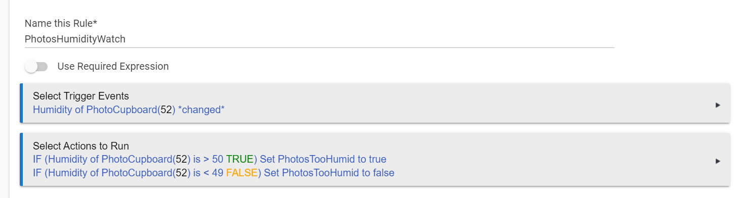

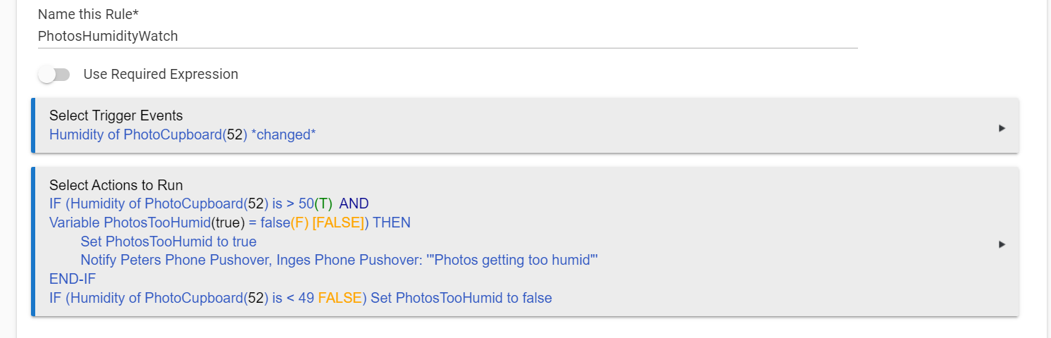

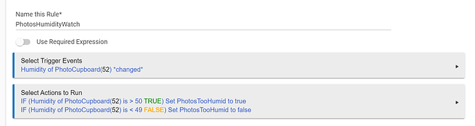

What I did in a similar conundrum is set up a hub variable called "PhotosTooHumid" and when the value of the humidity sensor first went above the threshold it sets it to true via a rule. In fact it sets it to true every time but the event of the variable changing only happens the once. Then you only get notified the first time it gets set to true if your rule is monitoring the variable rather than the device. When it's below the threshold by a certain amount set it to false. Leave a slight difference between threshold for off and on, then it won't bounce while changing
It would be worth posting a screenshot of the rule you have set up. Can you use a private boolean. The private boolean being true as the required expression in RM. Once the rule triggers, the first action sets the private boolean false. Once your required actions have been carried out (notifications sent and I assume a wait until the temperature difference is back within limits), set the private boolean back to true again. That should stop the rule re-triggering with every periodic report from your temperature sensor.
