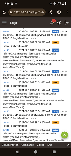

I had a guest try to get in and I want to know what code they were using. The logs just show command 9881 with a hex payload I can't understand.
00 71 05 a1 01 00 ff 06 10 00

It appears the driver code displays the raw Parse, and is then followed by the decoded message. In other words the message is output via Debug, twice. THEN you get the Warn message wit hthe 3rd interpretation :slight_smile:
Screenshot 2024-08-10 at 8.01.03 AM
161 in decimal is 0xA1 and zwaveAlarmStatus:255 is 0xff, etc.
It is probably one of the tamper/break in alarms the Schlage has which HE does not support or do anything with. There may not have been any code attempted, just maybe pounded on the door or lock a bunch.

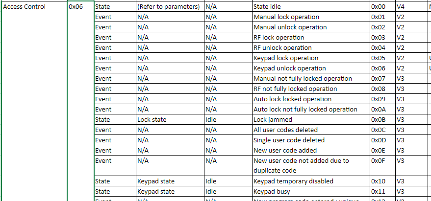

I dug into this a little more, the alarm command class is deprecated so this can be translated into a notification event using the zwaveAlarmType Event and Status
Type 0x06 is access control and event 0x10 (16) is Keypad Temporarily Disabled
No idea why, but thats what the message means.
