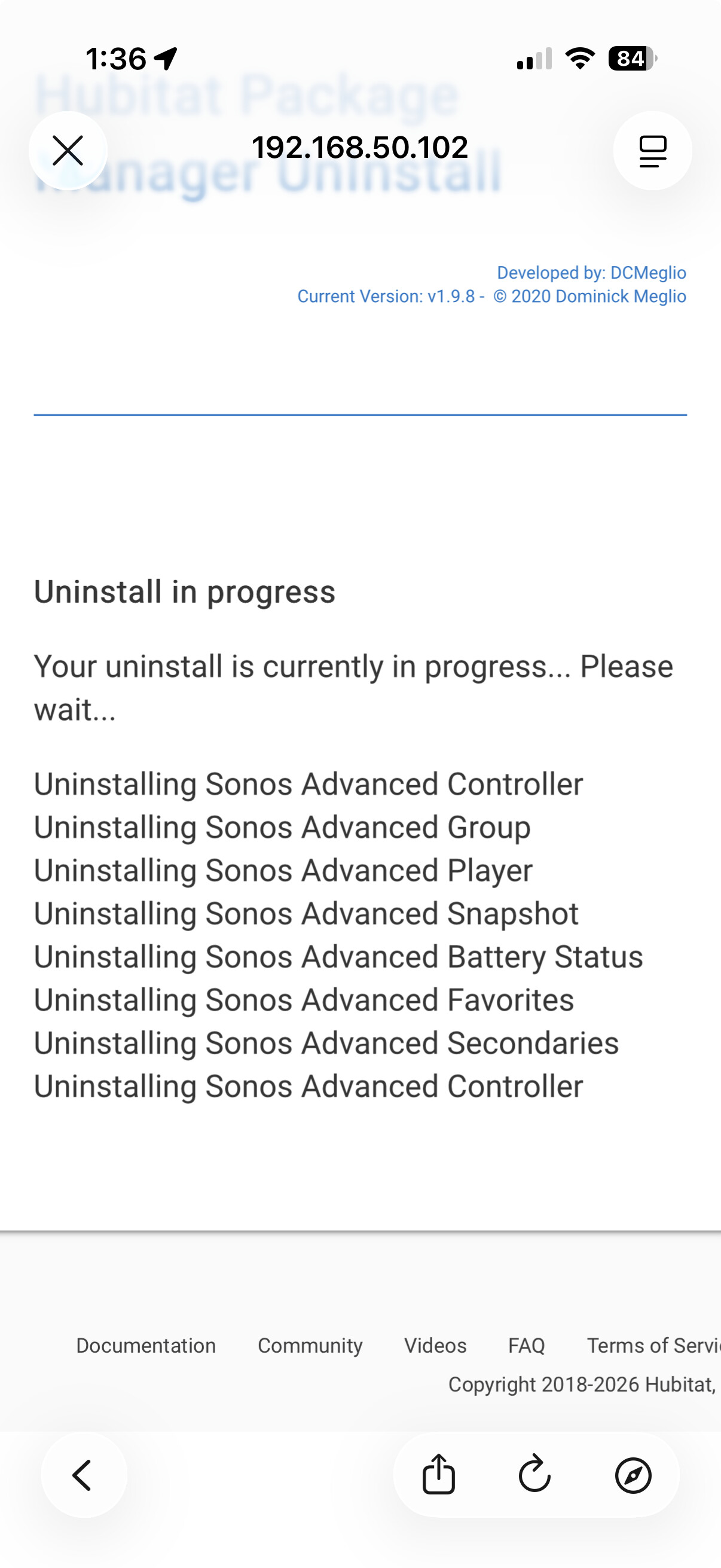

Tried installing the Sonos Advanced Controller by @daniel.winks via HPM. To say it was a failure is a compliment. Tried doing a repair through hpm which it did. Nothing showed up in devices or in apps. Tried doing an uninstall using hpm and it just hangs on Uninstalling Sonos Advanced Controller and game over… Backed out of hpm and tried uninstalling again and received fatal error, did a repair - success, uninstall - well you get the picture. Any ideas and or help would be appreciated. Also any documents on this very interesting app would also be appreciated.

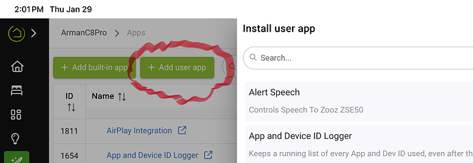

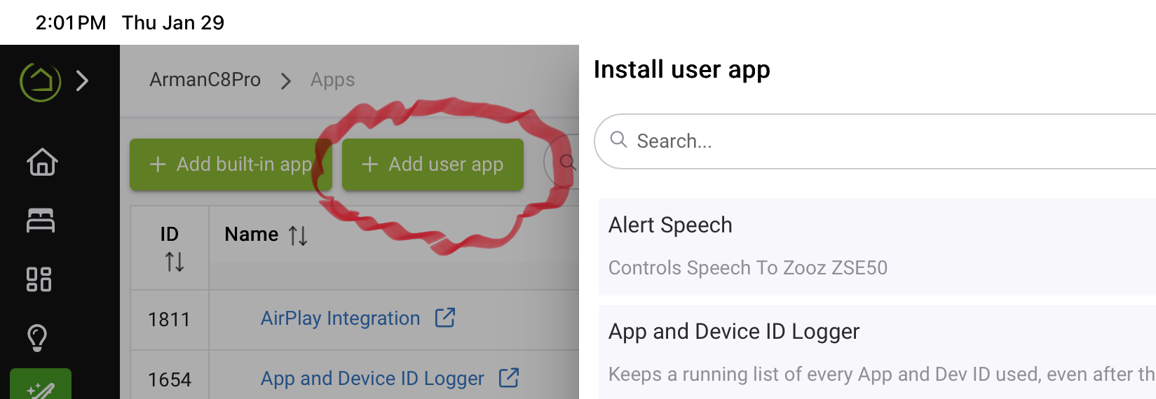

After “installing” you did remember that you have to “add” the user app?
… and possibly “add” devices that you have installed.
User app??? Thought him installed everything. Where is this user app?
HPM installs the app and driver code (i.e. the Groovy code that encompasses the app and/or driver).
For an app, the end user will still have to use the button indicated by @TArman to install the downloaded code as an app.
For a standalone driver, the end user will have to assign that driver to the desired device from the device page.
