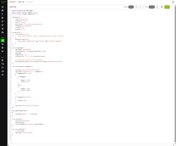

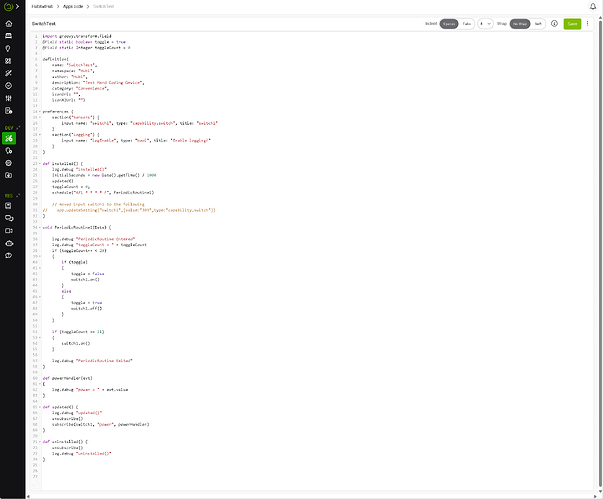

Appreciate the tip. I made a test program that uses the "input" statement as follows:

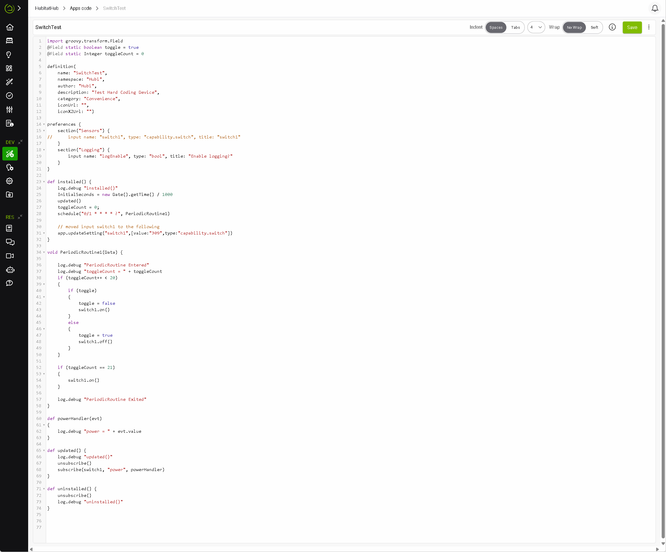

I then used your tip and changed the program on lines 16 and 31:
After changing those lines to comply with your tip (no input line) the periodic routine still worked but the subscribe for power did not. Do you have any words of wisdom?
You are running updated(), where you create that subscription, before you set the value of the preference on which the call to subscribe() depends.
Also noting that this workaround/behavior is (intentionally) undocumented and not guaranteed to be future-proof. :slight_smile: (Something that would be: saving the value in a parent app and setting the child app to that, if it makes sense to do that with whatever you're writing -- and then choose the device in the parent since you only want to do it once. But anyway...that's the reason for the above.)
Thank You... Thank You! It was exactly the solution. I moved the Subscribe right after the app.updateSetting and things are working great. I can now change some of my custom programs that require TONS of input's (That never will change) to hardcoded devices! I am a happy camper.
