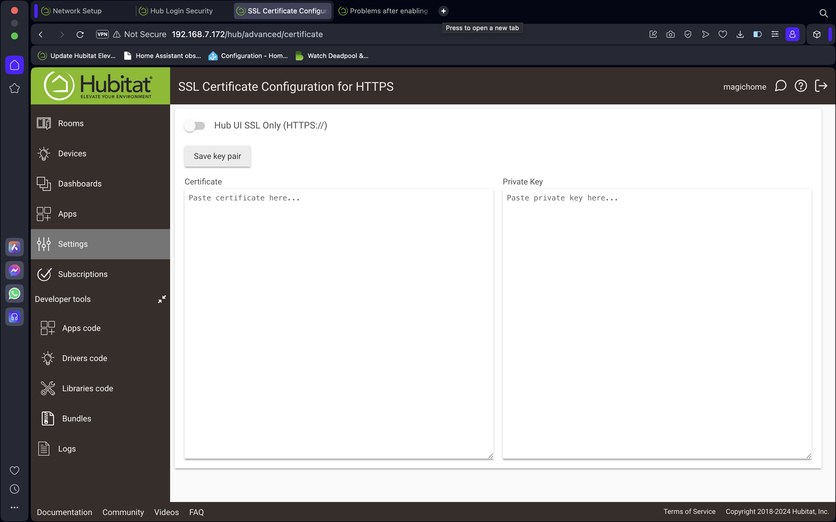

hello cleaver people, please if you have the time can you please explain to me how to enable https and disable http so I have extra security. I am a very slow learner and will be nice but dim, please have patience with me. sorry to be a pest. I am a little worried about taking the next step and getting locked out of my hub.

Another thing I noticed in the OP’s screenshots above is that there’s a “VPN” tag in the browser address bar.
So @postmanjess it might also be helpful if you can elaborate a bit on how you’ve integrated a VPN while doing your web browsing.

I think you mean the built in vpn with opera its subscription so I don't have that one activated, I do use eero with the security package and that has a vpn for browsing, useful if watching a movie I cant get in uk. I also use Tailscale on all devices but haven't a clues of the advantage
