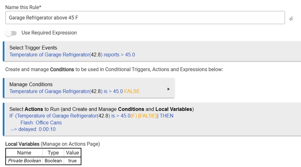

Attached rule that worked when clicked on run but now does not work.

Log says 45.0(F) [FALSE]) THEN (skipping)
Remember that Hubitat is event based. Your rule will run any time the temp sensor reports over 45°, which may be more than you want. If it is reporting 45° and you want it to run you need a >= comparison in your trigger.
Your conditions are the same as your trigger. So you don't need the condition. Even though you don't technically need it, you should finish the IF statement with an END IF.
Your flashing will start only after the 10 second delay.

I would suggest that you enclose the rule with the Private Boolean idiom and put the private Boolean in a required expression for the rule. You could be being hit by multiple triggering and concurrent execution, causing multiple flashes that appear as no flash.

Action: IF (Temperature of Garage Refrigerator(38.3) is > 45.0(F) [FALSE]) THEN (skipping)
Skipping, after the THEN, means that the IF test was False, as it says, so the action after the THEN is skipped.
I.E., 38.3 is NOT > 45.0, as tested in the IF condition, and shown by FALSE.
You were right about concurrent execution, the rule clashed between the Trigger Event and the Condition I had included.

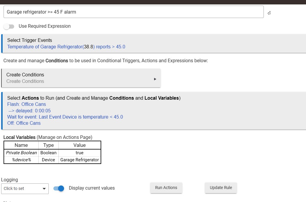

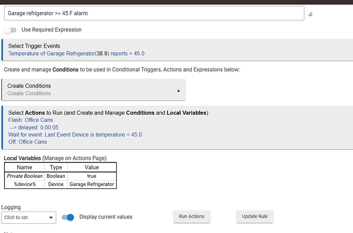

Attached is the final Rule that is working well so far.

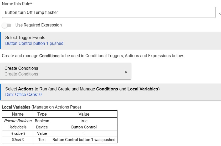

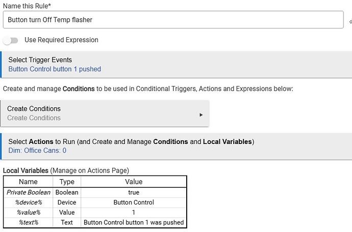

Now I'm trying to figure out how to create a button that will STOP the rule from running when the temp goes over for a long time. The button rule I now have does stop the lights from flashing for a bit of time but then starts again.
Also, attached. Sure it is not coded right.
Ok, if you are having concurrent execution, here are the steps to fix:
Enable Required Expression, define a Required Expression of Private Boolean is True.
Insert a first action for the Rule of Set Private Boolean False.
Add a final action of Set Private Boolean True.
The second rule you wrote will turn off the lights but not stop the first rule from running. At the next temperature report over 45, the lights will resume flashing.
There is a couple of ways to achieve what you’re looking for. One is that there is rule action available for pausing another rule. You could use it prior to turning off the lights in your second rule. You would then need to add some means to resume the first rule as well. Another one would be to use the state of a switch (buttons are momentary) in your first rule’s required expression.
